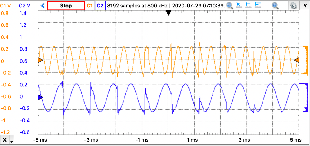

I have moved forward with a ping-pong approach using I2S interrupts and placing the DSP workload (transfer and processing of input samples to output samples) in the while {} loop at the end of main {}. My thought was that the while the Tx() and Rx() I2S callbacks were doing their thing of shuffling ADC/DAC samples via I2S, there would be plenty of processor time to do some processing with the samples passing from input to output. This does not work as expected and now I am stuck on what to do try next. Samples are getting dropped regardless of the buffer length I choose, so the waveform is discontinuous. My code listing is below followed by a scope screenshot. Not here I am using a sinusoid LUT to send 1kHz and 2 kHz sinusoid samples to the output buffers, but input to output streaming works similarly.

    while (1)
    // Begin DSP processing using the int16_t pointers tx_buf and rx_buf to the ping or pong buffers
    // For a LUT sinusoid put table values in left and right channels using a modulo table index
    if ((tx_ready && rx_ready)) {
    for (n=0; n < NSAMPS; n++) {
tx_buf[2*n] = onek_table[table_indexL]; //rx_buf[2*n]; // Process left samples
tx_buf[2*n+1] = onek_table[table_indexR]; //rx_buf[2*n+1]; // Process right samples
table_indexL = (table_indexL + 1) % N_period; // stride by 1 <=> 1 kHz
table_indexR = (table_indexR + 2) % N_period; // stride by 2 <=> 2 kHz
    tx_ready = false;
    rx_ready = false;

Screen shot when using 50 sample input and output ping-pong buffers, which give ~2ms end-to-end latency.
Any suggestions? Should I have a dedicated interrupt while I transfer and process the samples?
5,928 次查看
Sabina_Bruce
Hope you are well. I've been checking your code with detail and the description  you provided. I believe the interrupts are fine, they should remain as simple as possible to not bring any unnecessary delays. I noticed in your transfer call back you are filling the ping on both conditions of the IF statement. Is this correct?
An additional feature that you could implement is as soon as you finish the process of the sample trigger DMA transfer. You may use the example provided in the SDK called i2s_dma_record_playback. It is pretty much what you have in your code above with the added DMA.
Let me know your results.
Sabina
