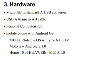

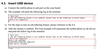

Hi @seobi ,
Thanks for your interest in NXP MIMXRT series!
The board's jumpers just need to be left as default, however, you will need an adapter and to connect the phone to the board.
Check out this document for details on how to test this: boards\evkbmimxrt1170\lwip_examples\lwip_dhcp_usb\bm\cm7\MCUXpresso SDK USB RNDIS & LWIP User Guide.pdf
Gavin_Jia_0-1727059681081.pngGavin_Jia_0-1727059681081.pngGavin_Jia_1-1727059707164.pngGavin_Jia_1-1727059707164.png
