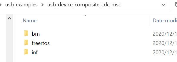

I want to build the example project dev_msc_sdcard_freertos or dev_composite_cdc_msc_sdcard_freertos, but when I download the SDK using the MCUXpresso SDK Builder I do not see either of the above mentioned folders in the downloaded zip file. The only ones I can see are the non-RTOS versions.
I've tried the 2.8.6 version of the SDK, 2.9.1, and the RT1064, RT1060 and RT1050 SDKs to see if I can find it anywhere, but I still can't find it.
Does such a thing exist?

Thanks, I did manage to find the version with freeRTOS but only if I don't select MCUExpresso as the IDE - I assume I can just port this into the IDE?

1) I assume I can just port this into the IDE?
-- Yes, of course.

Please select the [Select ALL] when building the SDK library, then the SDK library will have the FreeRTOS version of USB demos.
