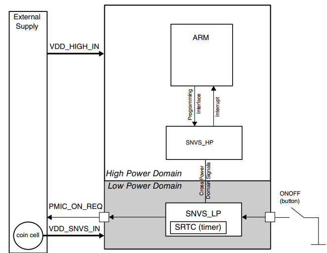

Hopefully this is just a dumb question, but I don't see any of the SDK samples to demonstrate keeping the RTC running across power cycles.
I am using an imxrt1052 with VBAT_IN (VDD_SNVS_IN) fed by a 3V coin cell.
I tried setting and then commenting out the call to: SNVS_HP_RTC_SetDatetime(SNVS, &rtcDate);
but the clock is still reset after a power cycle.
Is there something I am missing to keep RTC running across cycles?

jorge_a_vazquez
Hi Jack King
From the Reference manual:
SNVS_HP is in the chip's power supply domain and thus receives power along with the rest of the chip, which is off when the system power is down.
If the SNVS_LP power input is connected to an uninterrupted power supply, the GPR value is maintained when the main SoC is powered off.
I hope this info helps you.

jackking
Senior Contributor I
OK, that at least pointed me in the right direction.  The SDK sample "snvs_lp_srtc" demonstrates syncing the hp_rtc and the lp_rtc.  I was able to confirm that this sample does allow using the RTC across power cycles with a coin cell connected.
It does require commenting out the lines that set the lp_rtc after the first execution:
    /* Set SRTC time to default time and date and start the SRTC */
//    SNVS_LP_SRTC_SetDatetime(SNVS, &srtcDate);
//    SNVS_LP_SRTC_StartTimer(SNVS);
