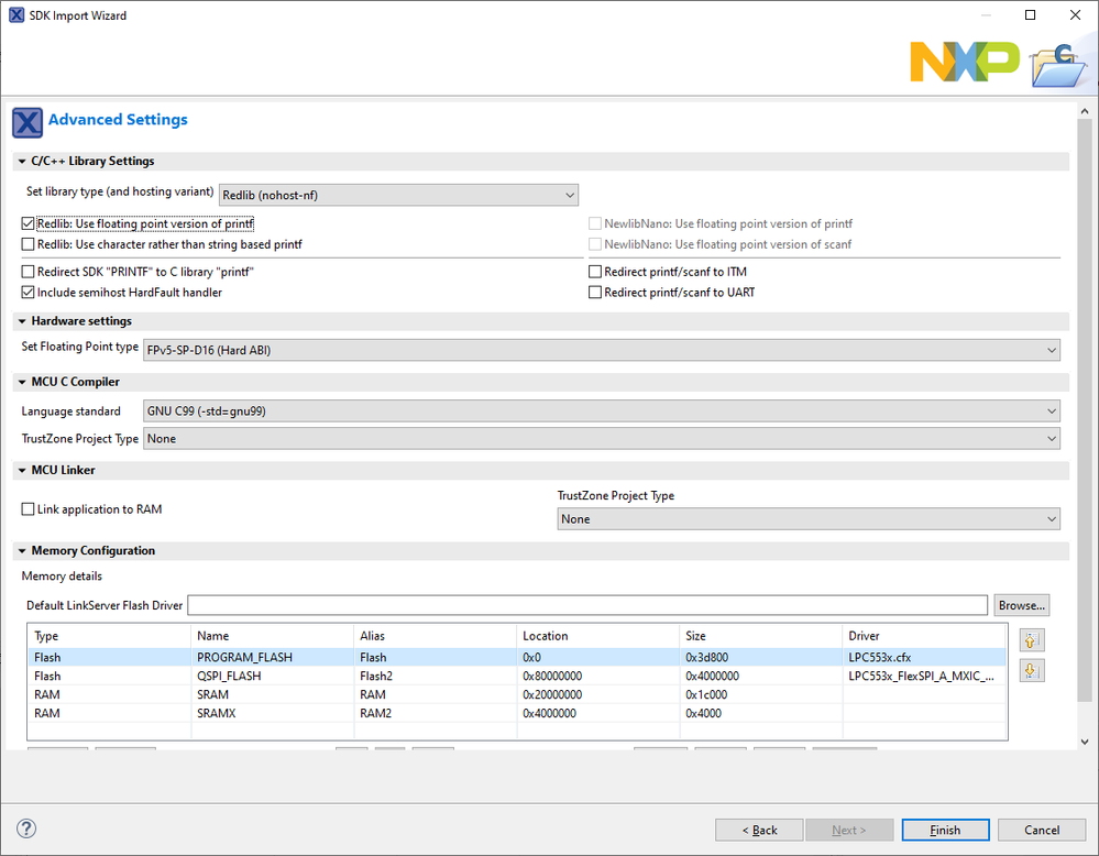

Using mcuxpresso IDE 11.9.0 open "Import SDK example(s)"...
select lpcxpresso55s36 board.
select the "hello_world" project under "demo_apps" and click next.
Check the box "Redlib: Use floating point version of printf" and leave other settings at default values.
I have modified main() by adding 4 lines using PRINTF.

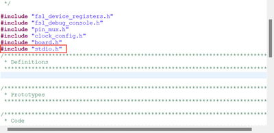

You can try it out by following these steps:
1. Add #include "stdio.h":

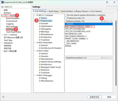

2. Set macro definition SDK_DEBUGCONSOLE_UART=1, right-click project -> Open the properties window and refer to the following image:
3.Use the printf () function to print normally.

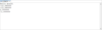

The results are as follows:
