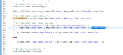

The implementation in the driver is the underlying function, for the management of seconds in ptpd, it is in the application layer, the implementation, your concern is correct, in this software, we do not use the seconds in the driver directly, but use other methods.
Please check this function implementation:
Gavin

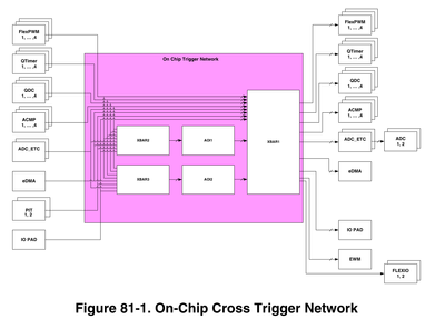

Unfortunately, I don't think XBAR can be used because I don't see any connection to or from ENET(_1G)
So it will require you guys at NXP to find another way to guarantee the “true” consistency between seconds and nanoseconds even on ENET(_1G)
