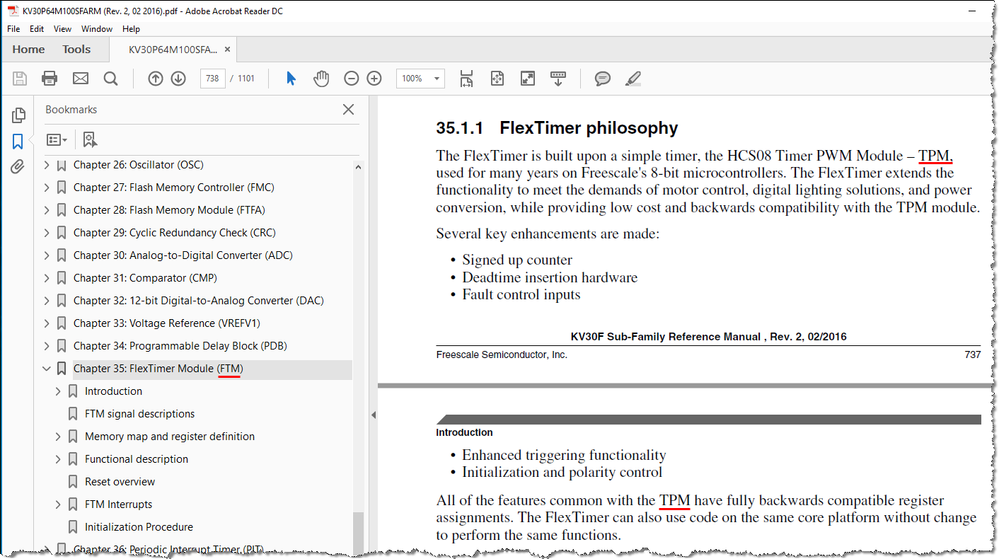

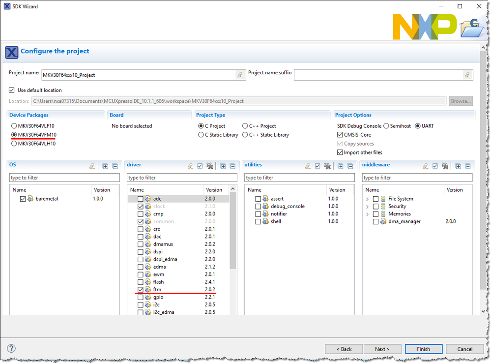

Hi all, I need to develop a simple PWM feature on a board with Kinetis KV30F MCU. Reading on web I found out examples using TPM driver (Timer PWM Module) but when I try to create a new project there's no TPM driver in the driver list: Do you know why? Is there another way to do it?
Attached you'll find a picture of "my driver list".

Please select ftm driver.
