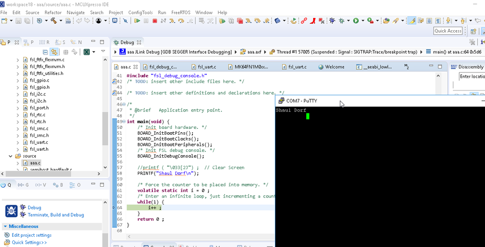

Using MCU config tools to configure UART doesn’t solve the problem.
In attached to can see my solution (doc and project zip).
Shaul

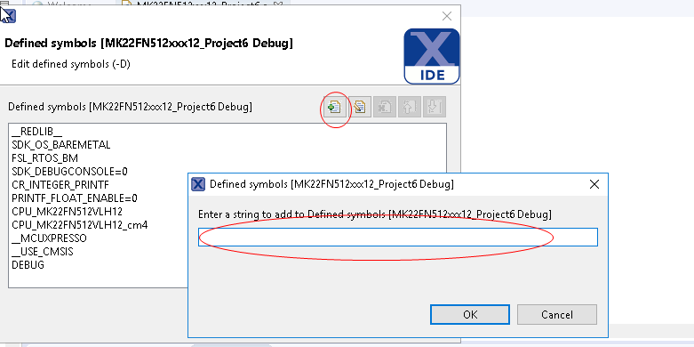

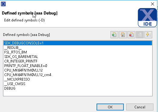

Hello shaul dorf,
Please add the definition of "SDK_DEBUGCONSOLE" as below :
then clean , build your project , it can work well , I test on my side :
Hope it helps,
TIC

Alice Thanks
Sorry I don't know where to fined this definition of "SDK_DEBUGCONSOLE"?
Shaul
15,026 Views
Hello Shaul,
I take screenshots to show the steps :
Hope it helps,
TIC

shauldorf
Contributor V
Hello Alice
I just created new empty board project and have added:
SDK_DEBUGCONSOLE=1
REDLIB
FSL_RTOS_BM
SDK_OS_BAREMETAL
CR_INTEGER_PRINTF
PRINTF_FLOAT_ENABLE=0
CPU_MK64FN1M0VLL12
CPU_MK64FN1M0VLL12_cm4
_MCUXPRESSO
USECMSIS
DEBUG
The result was no print to terminal or console.
In my demo that you have tested I changed board.c file to support debugger.
I have attached doc. file how to create empty project that will support printf.
I'm attaching this doc. again.
A. So my question is:
1. using this doc I generate empty project (as a template for empty project)
2. export this project as zip file
3. import it to working space
4. rename it and use it for a new project.
What wrong with this procedure?

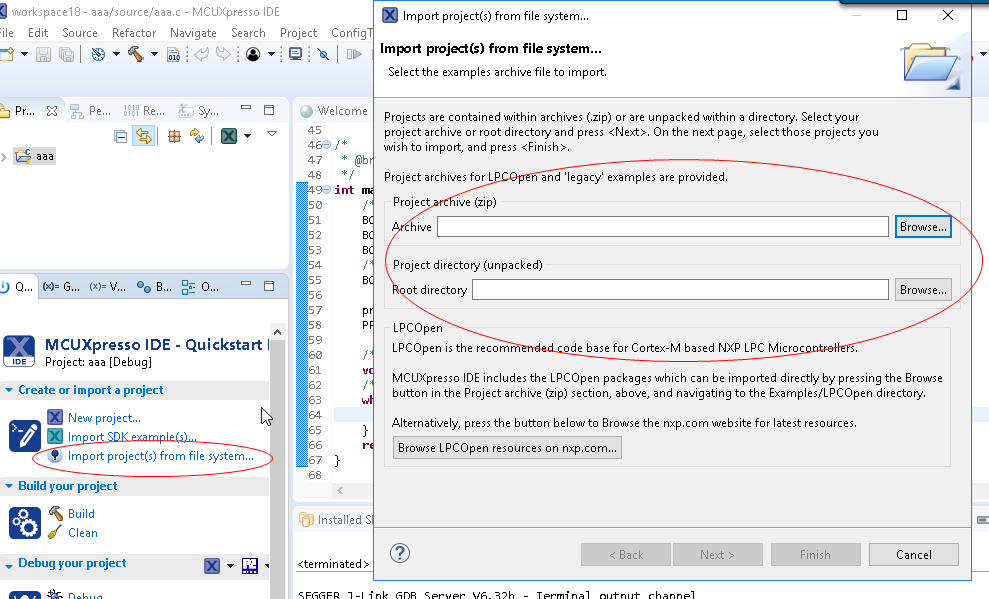

Hello Shaul,
Your proejct can work well on my side.
When you import proejct, Recommend you use import project button in Quickstart Penal :
TIC
