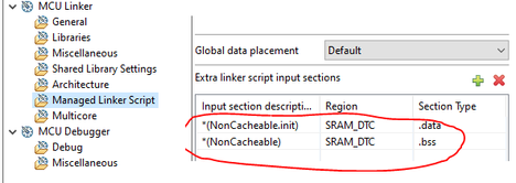

I have now found the crucial difference between the .cproject files:
<option IS_BUILTIN_EMPTY="false" IS_VALUE_EMPTY="false" id="com.crt.advproject.link.memory.sections.1186610869" name="Extra linker script input sections" superClass="com.crt.advproject.link.memory.sections" valueType="stringList">
<listOptionValue builtIn="false" value="isd=*(NonCacheable.init);region=SRAM_DTC;type=.data"/>
<listOptionValue builtIn="false" value="isd=*(NonCacheable);region=SRAM_DTC;type=.bss"/>
</option>
The cproject file of the project created from scratch did not contain these two option values. If included LAN-connection works every time. But now the question is: What do these two linker sections mean and why are they crucial for LAN-communication via phy, mdio and lwip libraries?
Note: As discovered earlier for a full solution the preprocessor directive FSL_FEATURE_PHYKSZ8081_USE_RMII50M_MODE must also be defined.
</option>

jeremyzhou
In the ethernetif0_init() function, the RX and TX buffer descriptors should reside in the NonCacheable RAM, otherwise, it will encounter an issue if the NonCacheable RAM is missing.
