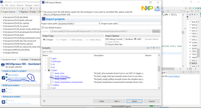

Mr Scott,
Thank you for pointing out the disadvantage of SDK and giving the recommendation.
I suppose that you use LPC55S69, the ADC converter of LPC55xx is different IP from that of the other LPC family, it is more complicated that that of 12 bits SAR ADC the other LPC processors integrate, so the description in both UM and SDK for LPC55xx is not perfect.
From customer perspective, pls download SDK package from the link:
https://www.nxp.com/design/software/development-software/mcuxpresso-software-and-tools-/mcuxpresso-s...
You can refer to the ADC example in SDK.
Then you can test the ADC example.
If you have additional requirement for example hardware triggering mode or multiple channels sampling, pls update the ticket, we can provide support further.
Hope it can help you
