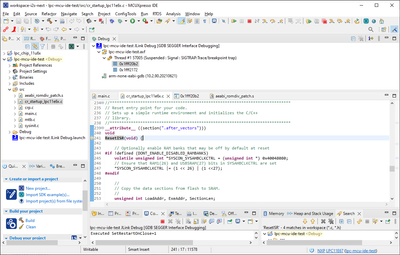

I'm trying to create a lpc11e67 project, and debug using MCUXpresso. I know the board I have works and the J-Link debugger connection works because I have a separate Keil project that I can run on the board (with Keil IDE) without issue. I am trying to move from Keil to MCUXpresso.
I downloaded the lpcopen_3_03_lpcxpresso_lpcxpresso_11e68 code from here https://www.nxp.com/design/software/development-software/mcuxpresso-software-and-tools-/lpcopen-libr...
There is no lpc11e67 specific download that I can find.  The project is nothing more than the default while(1) loop so I would not expect there to be an issue.  I can connect to the debugger, start the debug session but the code immediately goes off into the weeds.  See the screen shot below.  The debugger does not stop at main, nor anywhere else.  It starts to run immediately.  When I click the pause button, it is off somewhere it shouldn't be (address 0x1fff20b2 ??).
I created the project through the Quickstart panel: New Project->LPC11E67, LPCOpen - C Project, then selected the requisite LPCOpen paths to locate the code.  Clicked through all of the default settings and built the code.  To debug, I went through Debug As->Segger J-Link Probes.  I have tried various ways to create the project but they all result  with the same issue.  Is there something simple I'm missing to get things configured?
Ive attached the workspace and project. The workspace was created new as well.  Thanks for any help in advance.

I have tried including those, but the results are the same.  Attached is a workspace with a requisite project.  I was able to get the code loaded and programmed in OZone, and break at ResetISR.  If I step through the assembly code, it generates a hard fault at address 0x18A, when it is trying to store the enables back to SYSCON_SYSAHBCLKCTRL.
I have tried various things to fix this.
1.) I defined DONT_ENABLE_DISABLED_RAMBANKS.  This gets farther of course but fails shortly after in the __USE_ROMDIVIDE section of code.
2.) I undefined __USE_ROMDIVIDE.  This fails somewhere in SystemInit().
3.) I added a startup assembler file to set the clock enable for SRAM1 prior to calling ResetISR.  That assembler file is excluded from the current build setup in the project.  There an associated #define USE_MY_STARTUP_ASSEMBLER_CODE you need to define if you want to use that code because the ResetISR entry symbol would now be defined in the assembler file.  This also fails.
