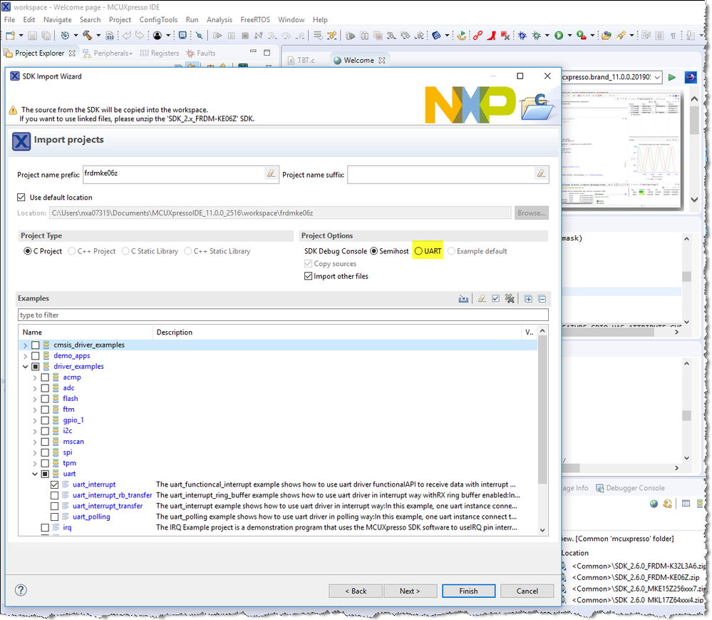

I am trying to run the driver example interrupt_transfer for the uart and the code isn't working properly for me. The readme.txt says that something should pop up on the log for the OpenSDA terminal that tells you to input a value but it's not appearing for me. Anybody know what my issue may be? Thanks in advance.

Seems that caused by the default selection(Semihost) of SDK Debug Console.

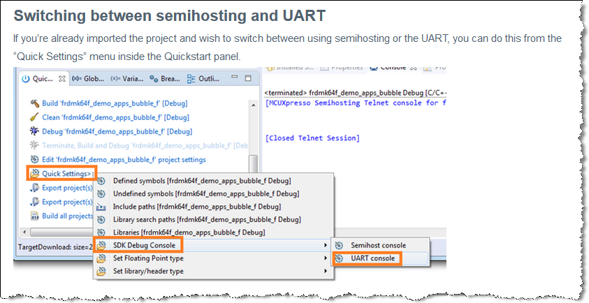

Please switch it to UART by refer: MCUXpresso IDE and Semihosting.
