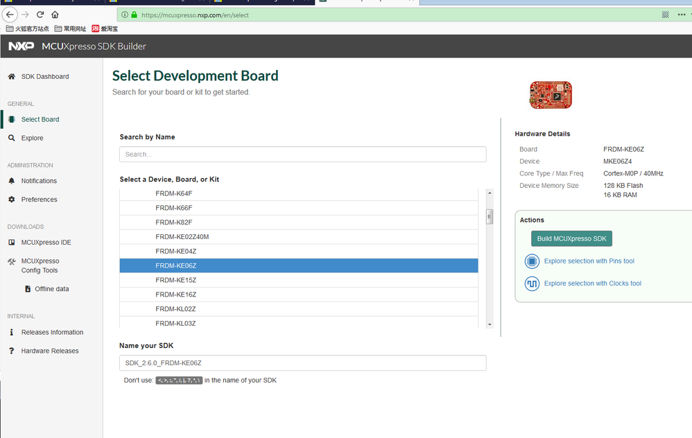

Hi Tyler Wong ,
   Please go to this link:
Welcome | MCUXpresso SDK Builder
   Select development board as FRDM-KE06, then generate the code and download it.
After you get the SDK_2.6.0_FRDM-KE06Z, you can unzip it, and refer to the doc document (Getting Started with MCUXpresso SDK.pdf)run the SDK code.
 The gpio code can be found in the folder:
  \SDK_2.6.0_FRDM-KE06Z\boards\frdmke06z\driver_examples\gpio_1
Please try it on your side.

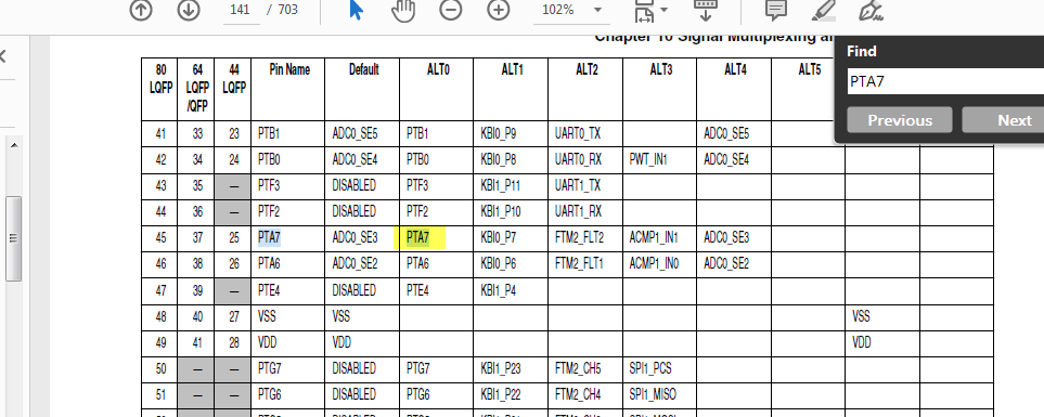

  If you want to configure GPIOA bit 7, PTA7 as the output GPIO pin.
  1. Check your hardware design about this pin.
     What's your LED circuit, if your led circuit is low to light your led, then you need to output the low signal to PTA7.
Vice versa.
  2. Software side
   You need to configure the the PTA7 as output pin, and output low or high.
Related register is:
 GPIOX_PDDR, GPIO_PDOR.
More details, please refer to the reference manual for KE06.
BTW, if you use it as GPIO, don't use the higher ALT function for PTA7:
Actually, you totally can refer to the official code and modify that code to PTA7.
Please try it, if you still have question, just let me know.
