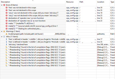

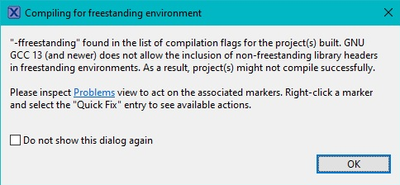

I have working c++ projects based on SDK 2.15 for MIMMXRT1170-EVKB.
When I upgraded to SDK 2.16 I got the following warning
Now my projects stopped compiling with a list of issues, that might be related to the
-ffreestanding option or not.
Is there release notes/migration guide for c++ projects from SDK 2.15 to 2.16?

Never mind. I just read gcc about -ffreestanding, removed -ffreestanding option from my projects, now they compile OK.
