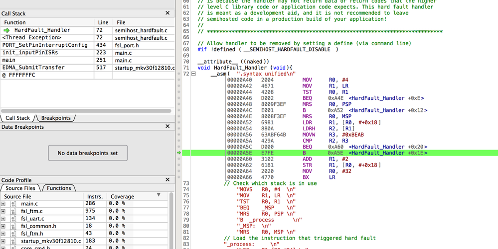

When I try to enable pin interrupts as follows;
PORT_SetPinInterruptConfig( PORTA, 1<<4, kPORT_InterruptEitherEdge );
PORT_SetPinInterruptConfig( PORTA, 1<<18, kPORT_InterruptEitherEdge );
PORT_SetPinInterruptConfig( PORTA, 1<<19, kPORT_InterruptEitherEdge );
EnableIRQ( PORTA_IRQn );
GPIO_PinInit( GPIOA, 1<<4, &sw_config );
GPIO_PinInit( GPIOA, 1<<18, &sw_config );
GPIO_PinInit( GPIOA, 1<<19, &sw_config );
It hard faults when running the PORT_SetPinInterruptConfig on PORTA18 and PORTA19.
The command on PORTA4 doesn't hard fault. If I put the A4 command last, it won't get past A18 or A19.
Fault-

xiangjun_rong
Hi, Kris,
I have checked the code, I think the pin definition is incorrect. you can try to modify the code as following:
modify to
PORT_SetPinInterruptConfig( PORTA, 4, kPORT_InterruptEitherEdge );
to
PORT_SetPinInterruptConfig( PORTA, 18, kPORT_InterruptEitherEdge );
to
PORT_SetPinInterruptConfig( PORTA, 19, kPORT_InterruptEitherEdge );
This is the source code of api function of PORT_SetPinInterruptConfig()
static inline void PORT_SetPinInterruptConfig(PORT_Type *base, uint32_t pin, port_interrupt_t config)
    base->PCR[pin] = (base->PCR[pin] & ~PORT_PCR_IRQC_MASK) | PORT_PCR_IRQC(config);
Hope it can help you

epicedium
Thank you, this is the correct solution!
