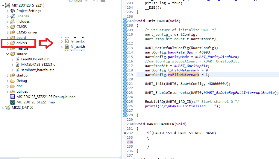

Hi, I just started using Kinetis and MCUexpresso.
I am having some issue with my UART - RS485 which I am not sure if i did it correctly.
I transmitted data to the board but it didn't trigger the Interrupt.
I have referred to MCUExpresso SDK API Reference Manual.
I am using at 12MHz Crystal with 22pF capacitor.
Core/System/Bus Clock is 48MHz.
I have RS485 communication initialized as follow;
#define UART0_HANDLER UART0_RX_TX_IRQHandler
#define UART0_IRQ_ID UART0_RX_TX_IRQn
#define UART0_ERR_HANDLER UART0_ERR_IRQHandler
#define UART0_ERR_IRQ_ID UART0_ERR_IRQn
void Init_UART0(void)
   /* Structure of initialize UART */
   uart_config_t uartConfig;
   uart_stop_bit_count_t uartStopBit;
   UART_GetDefaultConfig(&uartConfig);
   uartConfig.baudRate_Bps = 4800U;
   uartConfig.parityMode = kUART_ParityDisabled;
   //uartConfig.stopBitCount = kUART_OneStopBit;
   uartStopBit = kUART_OneStopBit;
   uartConfig.txFifoWatermark = 0;
   uartConfig.rxFifoWatermark = 1;
   UART_Init(UART0, &uartConfig, 48000000U);    UART_EnableInterrupts(UART0,kUART_RxDataRegFullInterruptEnable);
   EnableIRQ(UART0_IRQ_ID);
   printf("\r\nUART0 Initialized ...");
void UART0_HANDLER(void)
   if(UART0->S1 & UART_S1_RDRF_MASK)
Please advise.

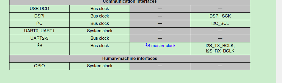

   You mentioned you are using the 12Mhz crystal.
   Do you check your core clock?
   The TWR-K21 is using the external 8Mhz crystal.
   UART0 is using the system clock as the clock source:
If your core clock is 48Mhz, then you can use :

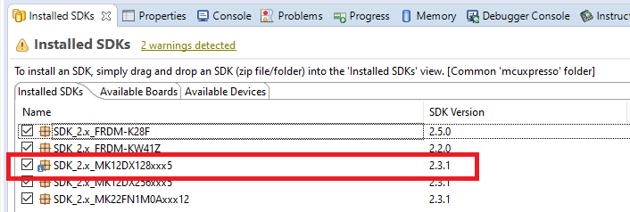

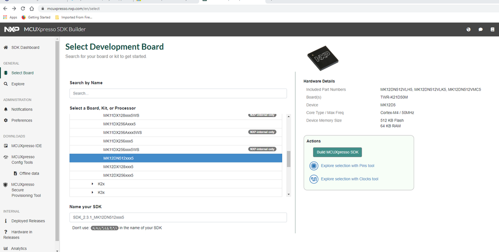

  I suggest you use our SDK code for your K12, which can be downloaded from this link:
Welcome | MCUXpresso SDK Builder
  Select your K12 chip:
Generate the SDK code, the SDK code already has the MCUxpresso IDE.
 After you download it, please refer to the get start document in the SDK/doc

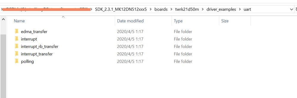

When you open the SDK project, it is for K21, but you can use the related driver, .s file to replace your project related files:
\SDK_2.3.1_MK12DN512xxx5\devices\MK12D5
The code already have the UART interrupt code.

I have installed the SDK when i created the project and the UART Driver is already in my project folder.
Are there any difference to use the driver from the example?
