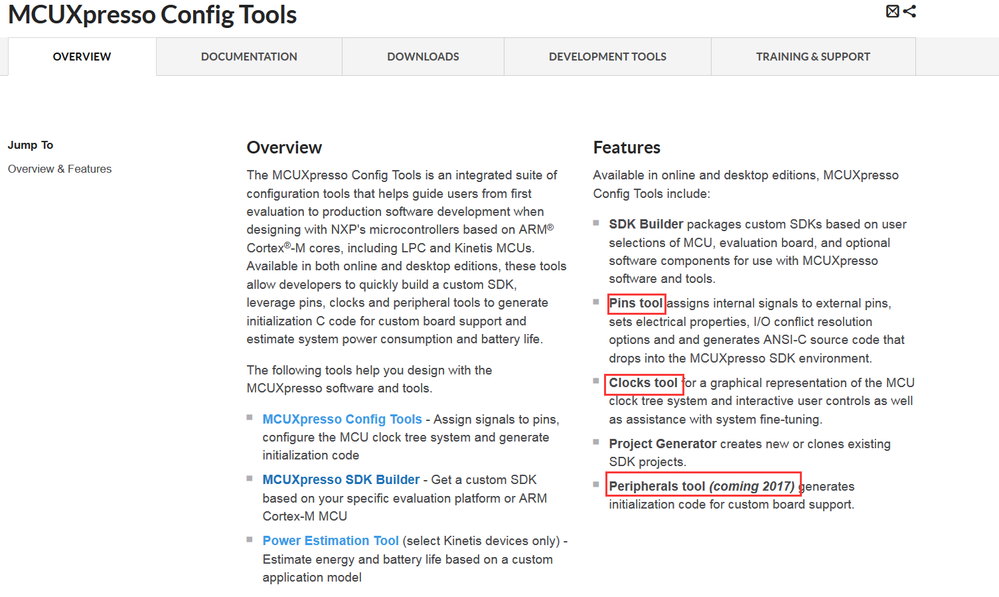

Hi Przemek,
1.  KSDK2.x (it also named MCUXpresso SDK) is the new one.  Only the KSDKv1.x(the latest one is KSDKv1.3) support
Processor Expert.
2. The MCUXpresso Config Tools replaced PE, MCUXpresso Config Tools|NXP
While it now only support pin configure and clock configure, the Peripherals tool haven't release.
Hope it helps

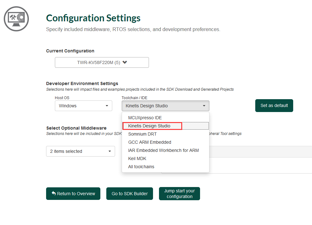

Hi Przemek,
If you want to use MCUXpresso SDK on KDS IDE, please choose KDS toolchain when download  SDK:
Hope it helps
