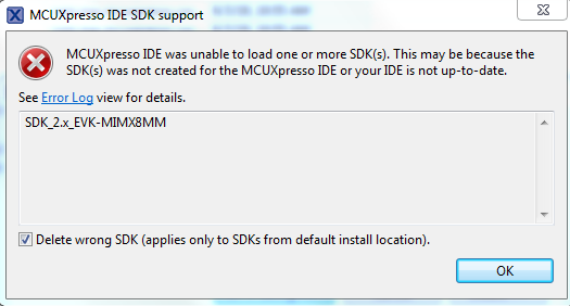

MCUXpresso v. 10.3.1_2233 IDE errors when attempting to import  SDK_2.5.0_EVK-MIMX8MM.  I tried loading a different SDK (SDK_2.5.0_EVK-MIMRT1015) and it worked just fine.  Is there any solution to this?  Perhaps a minor change to a manifest file will correct this issue?

the MCUpresso IDE doesn't support imx8 series SDK, only supports GCC ARM or IAR

Ok it looks like i need to use a different tool/IDE the documentation state "except MCUXpresso"

Looks like the xml entries in the manifest file do not mention MCUXPRESSO. Comparing with other sdks the manifest mention this as a tool chain. This is the likely cause.

The SDK 'SDK_2.x_EVK-MIMX8MM' does not contain any MCUXpresso IDE compatible toolchain.
