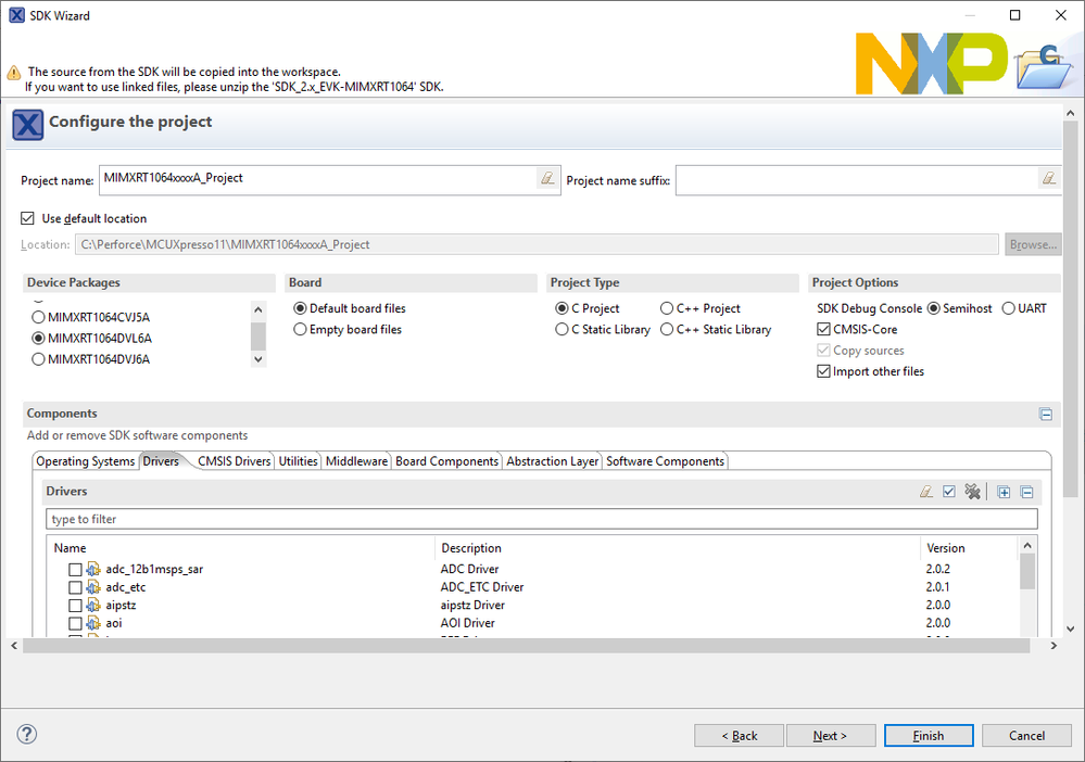

NOTE:  The flashing problem does not exist when creating example code projects.  It only occurs when creating a "new project" with the new project wizard.
With out making any changes to the default selections as shown below, the project will be created and will compile without issue.

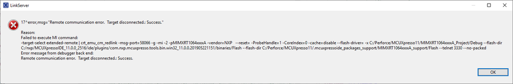

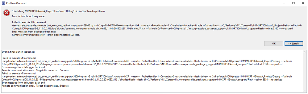

However, when I attempt to flash the code into the eval board by selecting debug I receive two error messages that are nearly identical.

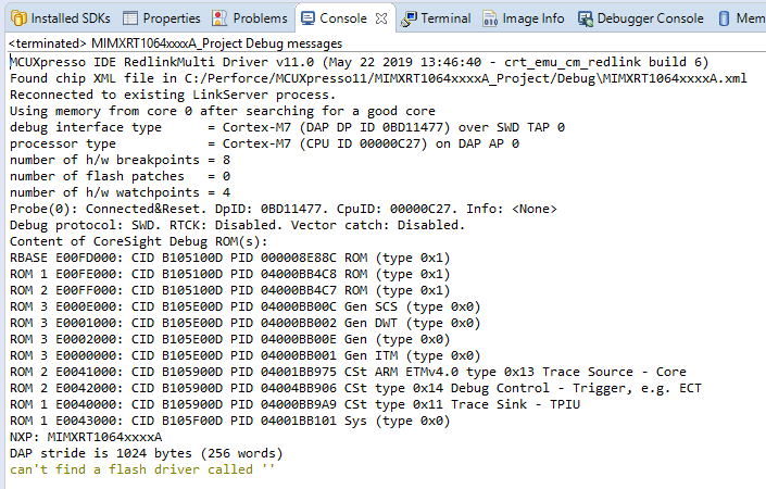

Here is what shows up in the console tab:

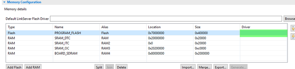

I can confirm this issue on my side. The problem is related to the flash drivers, by default, the project that you create doesn't select any flash driver:

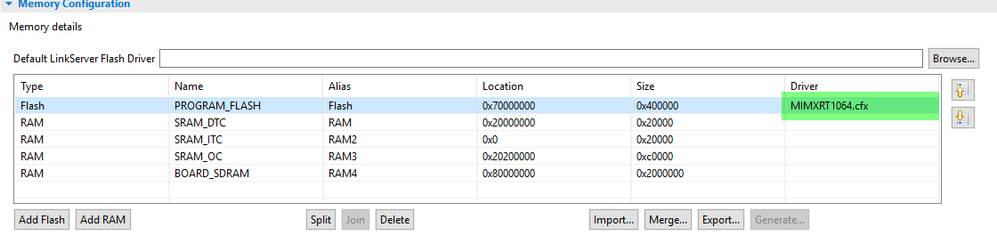

If you add it manually, the project works as expected:
