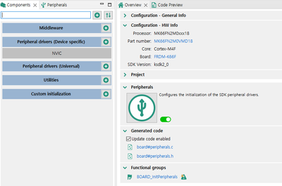

Hello
It seems to be a question like the one below, but I haven't been able to solve it.
https://community.nxp.com/t5/MCUXpresso-SDK/SDK-Config-Tools-ENET-MII-configuration-option/m-p/14713...
mk66 RM note // 1345p

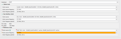

• An externally-supplied 25 MHz MII clock or 50 MHz RMII clock. This clock is used
as the timing reference for the external MII or RMII interface.
MII Mode   RMII -> MII
MII speed 100 Mbps
How to enable MII mode?
What do I need to fix to achieve that condition?

@DWK that's right, in that part is impossible to configure the MII, is in pins where you do that.

However, Is there no way to utilize the IDE?
If it's impossible with the IDE, tell me it's impossible.

Sorry, but i can't understand your question, the config tools are with the IDE MCUXpresso and the SDK is with the same IDE, so, can you explain with more details your question, please

Use the frdmk66f_enet_txrx_ptp1588_transfer example.
I want to utilize the Peripherals part in MCUXpresso Config Tool.
(MCUXpresso Config Tool > Peripherals)
Is MII setting impossible in that function?

Hi @DWK
If you open an example of SDK, your MII is enable
