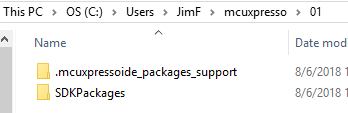

pcpro178
I ended up deleting the workspace and making a new one.  Since then, I discovered an mcuxpresso folder in my user directory.  It looks like MCUXpresso saves packages here deleting the right sub-folder(s) here could probably have resolved the problem without making a new workspace.

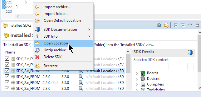

BlackNight
Hi Jim,
you can open the SDK location from the Installed SDKs view:
I hope this helps,
Erich
