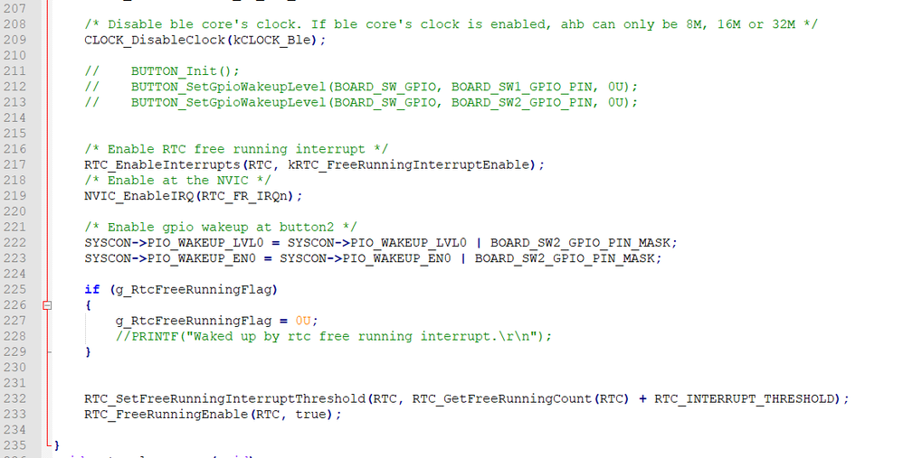

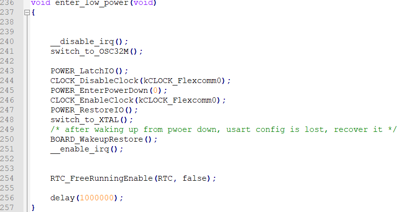

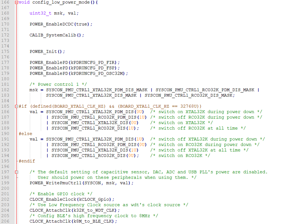

I am using the qn9080 board For the health thermometer project, and I tried to put the mcu in a low power mode. To do this, I was inspired from the qn908xcdk_demo_apps_power_mode_switch example,
and created two functions. The first one is called "config_low_power_mode()" in order to configure the low power mode and the wake up sources, and the second one is called "enter_low_power_mode()" to enter in low power mode.
I called these functions just before the end of the app_thread function, but the mcu woke up immediately.
you can find attached the images of those functions.
Please, do you have any suggestions ?config_low_power_mode1.PNGconfig_low_power_mode2.PNGenter_low_power_mode.PNG
