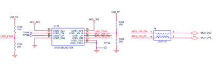

Deeps_bang
Hi Alice,
The USB detection issue solved by replacing divider circuit resistance 20k to 0k (DNI) at  'USB1_VBus'.
Thank you for the support.

Deeps_bang
HI Alice,
Thank you for response
Why i raised this question is, for few fabricated boards USB detection working fine. But for few boards USB device enumeration as HID Device  not happening . i.e Facing USB detection issue for few boards. PFA schematic of USB part. what could be the reason for this??
Deep_Bang

Deeps_bang
Hi Alice,
In ISP mode working fine. Detection problem in normal mode.
According to our analysis, problem might be at voltage divider circuit for USB1_VBus.
The LPC55s69 boards A0 /A1 version changes might be causing this detection issue .
for few boards detection will happen with divider ckt.
For detection error boards have plan to verify without this bias ckt.
Any input on this??
Deep-Bang

Hello @Deeps_bang
1) "The LPC55s69 boards A0 /A1 version changes might be causing this detection issue ."
->> Do you mean the issue can reproduce on nxp demo board LPCxpresso55s69-evk A0/A1? If yes,  you can tell me steps, I help to check on my side.
