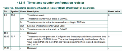

I know it is necessary to configure the Timestamp counter configuration resgister (TSCC) as follow on the page 753.
But, looking into the fsl_mcan.c implementation, I could not find any reference to TSCC register. It seems that the mcan driver not initialize this register and there are not any method to configure it.
Looking into LPC55S06.h file, I found the TSCC register declaration, as follow:
I tried to setup the timestamp using direct calls on the registers, but without success. I always read zero for timestamp.
My question is: mcan driver does not implement timestamp initialization steps?

Pls try to use the code to read the timestamp value:
CAN0->TSCC=0x01;
uint32_t temp=CAN0->TSCV&0xFFFF;
Hope it can help you
XiangJun Rong

clkunde
Hi XiangJun Rong,
Thank you for the support.
The code works fine. But the declaration CAN0->TSCC=0x01; should be used before the CAN interrupts enable and MCAN_EnterNormalMode function.
Now, I am able to read the timestamp counter correctly.
