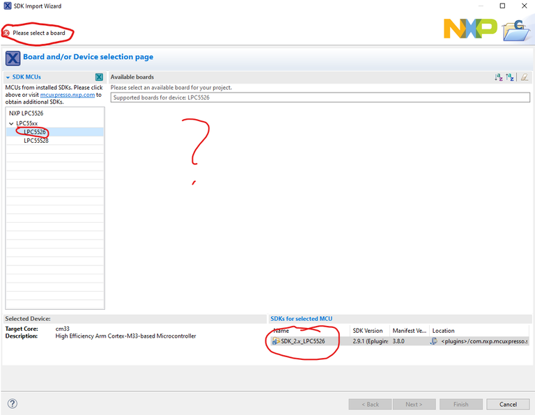

After playing with the lpcxpresso55s28 developer board, I created a custom board for the LPC5526.
Thus I installed the LPC5526 SDK.
Now I'm looking for example projects, e.g. simple led blinky and UART examples, but can't find one.
This is what I see after clicking on "Import SDK example(s)..." (in Quickstart panel) and clicking on "LPC5526" (under SDK MCUs):
As you can see, the wizard shows no boards for LPC5526.

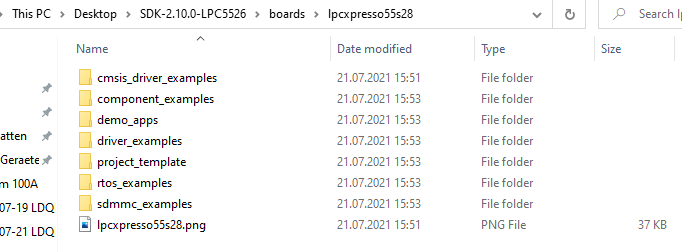

I wonder why this is as the LPC5526 SDK clearly contains a folder "boards" which contains a folder "lpcxpresso55s28" which contains examples:
LPC5526 SDKLPC5526 SDK
Is this a bug in the import example projects wizard?

As I mentioned, there is example code included in the LPC5526 SDK for LPCxpresso55S28 demo board, see below:
However, the "Import SDK example(s)" wizard does not show the board when clicking on LPC5526. I consider this a bug!

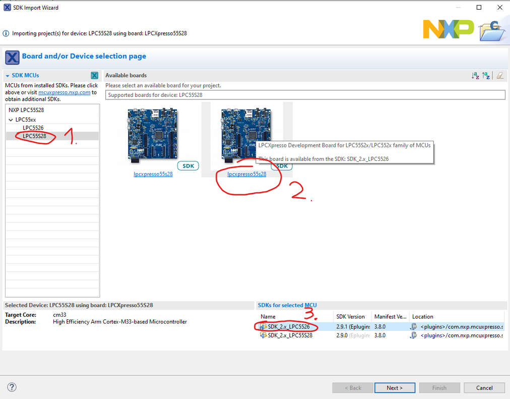

Workaround:
To select the board, click on LPC55S28. This makes two lpcxpresso55S28 demo boards appear. Now select the board that has the LPC5526 SDK associated with it.
Import SDK Examples WizardImport SDK Examples Wizard
