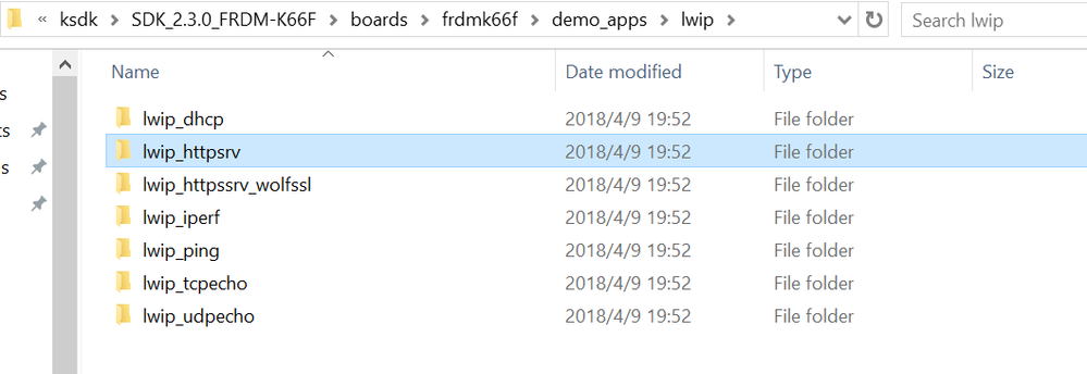

We're considering using K64F for an application requiring TCP/IP (DHCP, RFC2217, possibly http).
Is there a network example for Freedom FRDM-K64F board using FreeRTOS? Erich posted an example some years ago but that uses (deprecated) processor expert and KDS...
Thanks!

I found frdmk64f_demo_apps_lwip_lwip_httpsrv_freertos. I'll give this one a try...

danielchen
Hi Dave:
There are several tcpip demos under folder lwip, most of them with freeRTOS.
