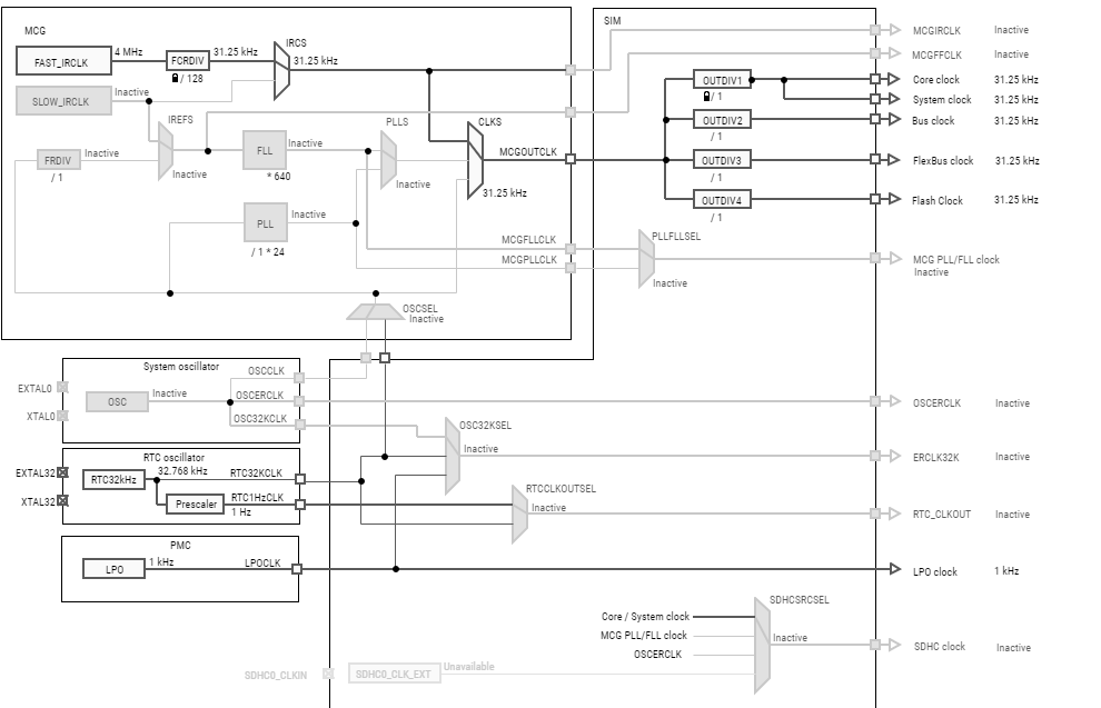

 where BOARD_Clock_VLLP is set as:

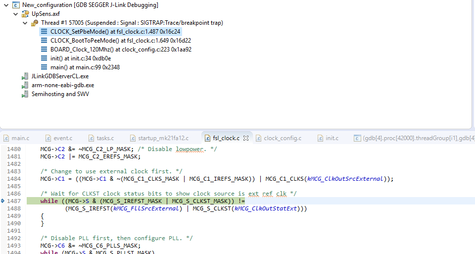

i have tried but the cpu stop in the function when wake up:
i have to unlock some register?

This is because you haven't cleared the ACK Isolation flag to releases the state of your clock. You do this with PMC_ClearPeriphIOIsolationFlag(PMC);
I noticed in your code that you have this function in your interrupt handler, maybe the problem is that you are calling initialization clock (BOARD_InitBootClocks();) before enable LLWU interrupt. I recommend you to first clear this bit as follow:
if (kRCM_SourceWakeup & RCM_GetPreviousResetSources(RCM)) /* Wakeup from VLLS. */
/* Init board hardware. */
BOARD_InitBootPins();
Hope this could help you.
