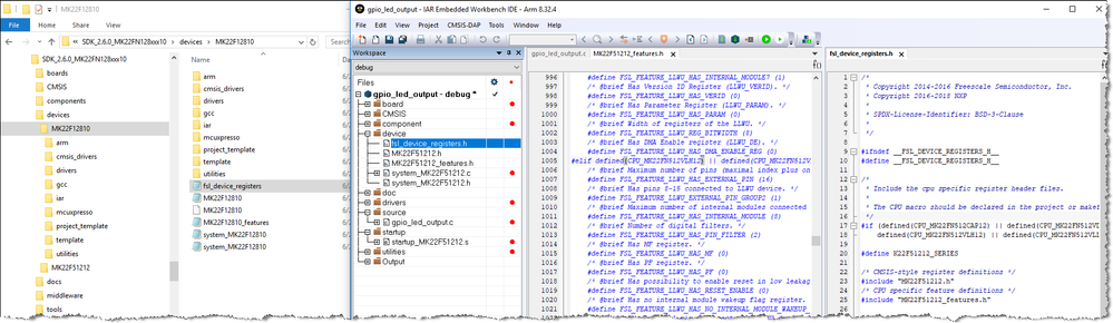

Hello
I have a question
I am working with IAR, it generates an error, where I can define my micro controller MK22FN128VLL10 and how to do it, I thank you very much
2 返答(返信)
2,053件の閲覧回数
Robin_Shen
Hi Oswaldo Tovar,
Please find the MK22F12810 related files in MCUXPresso SDK folder(...\SDK_2.6.0_MK22FN128xxx10\devices\MK22F12810)

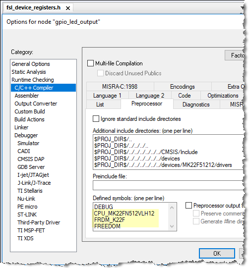

CPU_MK22FN128VLL10 should define in Defined symbols.
