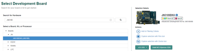

You can download SDK from below link, and import the zigbee examples according to below location:
To download SDK, Input the chip number: JN5189, then search and build SDK
https://mcuxpresso.nxp.com/en/select
Please remember to select "Wireless zigbee stack" in the next step, then click "Download SDK".

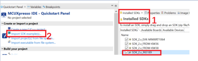

After download SDK finished, directly use MCUXpresso to install the SDK and import zigbee example is OK.
