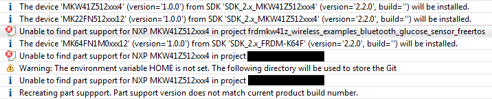

I try to build a MCUXpresso project though Jenkins for a while. The fact is that I have a java exception at the end of the build through Jenkins that I don't have in MCUXpresso. When I go to the .log file, it seems that this java exception is raised because Jenkins doesn't find the "part support" for the project (in my case the MCU KW41Z512xxx4).
By testing a lot of different configurations, here are all my clues :
- The build is working with a project based on a preinstalled MCU
- The build is not working with a project based on a imported MCU
- The command used to build in Jenkins works fine in the windows command prompt
- When I launch a command prompt from Jenkins with the same command than on windows, it doesn't work
It seems that Jenkins is not able to find the SDK configuration imported to build the project.
Any idea to solve the problem ?

nicolaslignée
As required by the User Guide, I downloaded the SDK from NXP website "build your SDK", I dragged and dropped the ZIP file in the tab "Installed SDKs" and that's it.
This morning, by opening my IDE, I found this on the Error Log tab :
In fact, even MCUXpresso doesn't find the part support, but contrary to Jenkins, It seems to be able to installed the device after-all.
What is the meaning of "Part support does not match current product build number" ?

nicolaslignée
Hi Kushal,
Yes, I solved my problem. It is working fine now.
To summarize the solution I found : Jenkins is not using the "same" MCUXpresso than Windows. The SDK installed in MCUXpresso was not reachable by Jenkins. I had to allow Jenkins to use the desktop, go to what I called "the background of Windows" where Jenkins is working and install the SDK in the MCUXpresso that I found there. (By asking Jenkins to open a MCUXpresso workspace and wait a bit to let me the time to investigate).
