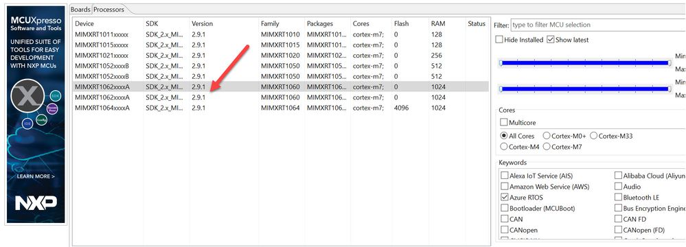

I'm trying to create an Azure RTOS project based on our board which uses the IMXRT1061 but I can't select any Azure RTOS components once i choose the IMXRT1061 Processor.
With release 2.9.1 of the SDK it was mentioned all IMXRT10xx are supported? is this the case for the IMXRT1061?
I have tried using the SDK Builder and also direct through the Eclipse SDK Plugins, i have noticed with the later when i filter for all Azure RTOS supported Processors the IMXRT1062 is listed twice but the SDK is different and one mentions the IMXRT1061, I have attached a screen grab.

jeremyzhou
Thanks for your reply.
1) Is there an ETA on when this will be updated?
-- To be honest, I can't promise the exact schedule of updating.
2) In the meantime Is there a workaround to enable the Azure RTOS components on 1061? Maybe rebuilding a copy of the SDK locally?
-- Maybe you can try the below steps to enable the Azure RTOS components on 1061.
a) Import both SDK libraries of the RT1062 and RT1061.
b) Load the Azure RTOS demo for RT1062.
c) Edit the MCU of the above demo, from RT1062 to RT1061.
Please give it a try.

JamieSimonsen
Hi Jeremy,
Thank you, your suggestion put me on the right path, unfortunately it wasn't straight forward to change the MCU and part and have MCUXpresso update the files correctly, it took some trial and error but I found the right order of steps to get it done and some manual copy paste from the sdk zip file got it done.

jeremyzhou
1) With release 2.9.1 of the SDK it was mentioned all IMXRT10xx are supported? is this the case for the IMXRT1061?
-- I already replicate the phenomenon that you described, and I think there's a bug in the Eclipse SDK Plugin and I'll report it in the next round of field trials.
