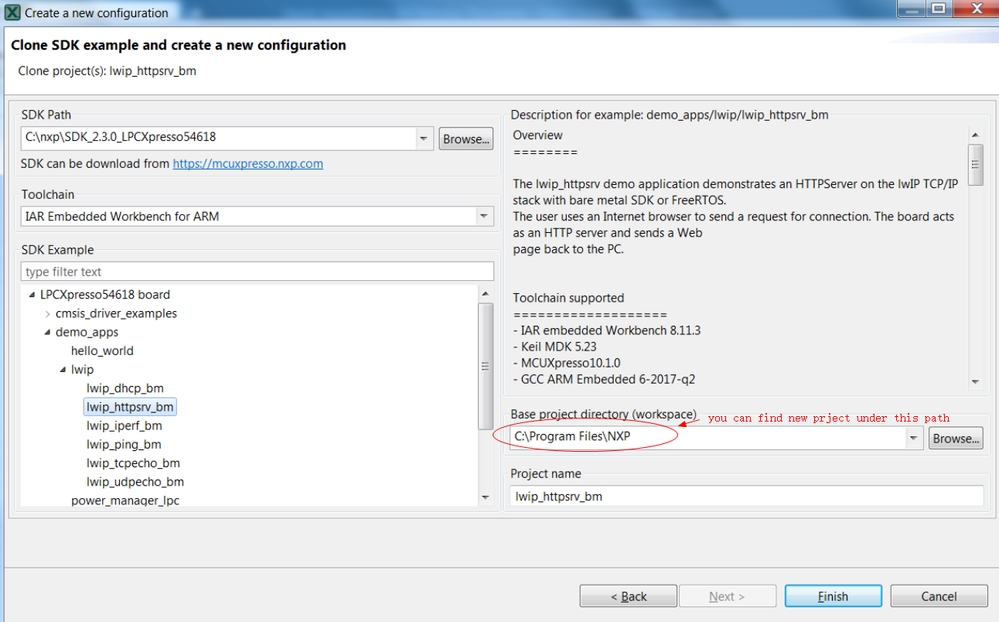

- About create a new proejct based on MCUXpresso SDK,  please use  MCUXpresso Config Tools , you can download from MCUXpresso Config Tools|Software Development for NXP Microcontrollers (MCUs)|NXP , after install , use the Project Cloner option : File->New->Clone SDK example and create a new configuration :
About the detail you can have a look at "MCUXpressoConfigTools_User_Manual.pdf" ->2.2.1.1 Project Cloner (I attached it for you .)
- In fact,  I think you can also directly open a SDK example based on IAR , then add your own code into it.

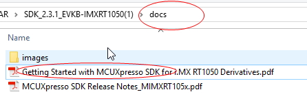

There is Getting Start under SDK package, it shows how to Run a demo application using IAR or other toolchains.

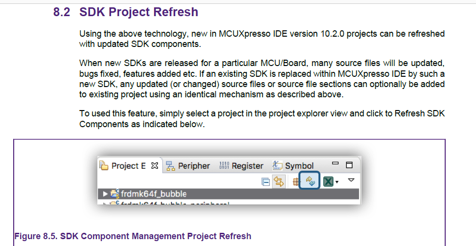

It seems there isn't a directly to uptate SDK.
You can create new project based on new SDK, then copy application code into it .
Or you can consider the MCUXpresso IDE, it can refresh SDK :

I see MCUXpresso SDK Builder supports GCC ARM Embedded, IAR, and Keil MDK. Is there any documentation/guidance on what to do after downloading an SDK build if you're targeting those tools?
