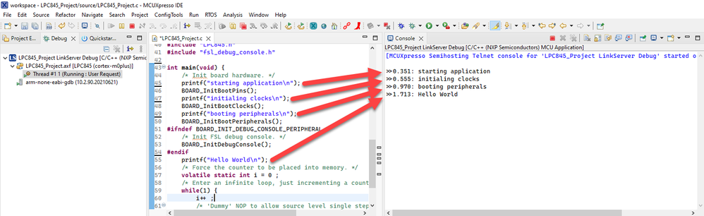

I prefer all printf() calls to include a prefix timestamp, so
  printf("something happened");
gives output
 00:01:30.555 something happened
in other words, the printf happened 1minute,30 seconds 555 milliseconds into the current debug session.
Typically I override printf() itself, and then redirect to the proper call.
I've gotten this to work when using a serial port UART (DEBUGCONSOLE_DISABLE), but I need it to print timestamps in Semihost Console mode DEBUGCONSOLE_REDIRECT_TO_TOOLCHAIN
I can't seem to find out how to create a hook into your SDK to override printf().
Hopefully, someone has done this before for Semihost Console mode.

Hi @Gretsch ,
I have been used the GNU linker wrap option for this for a long time. Your question reminded me that I probably should write about this, so I just finished it:
https://mcuoneclipse.com/2023/07/22/gnu-linker-wizardry-wrapping-printf-with-timestamps/
The cool thing with this is that you don't have to change your source code, just add a wrapper and a linker option. I'm using the is approach successfully for all kind of standard functions.
