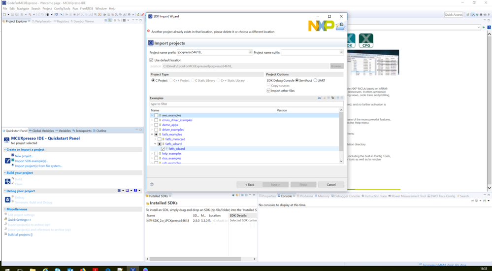

I post the screenshot of fatfs example.
Hope it can help you
