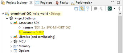

the MCUXpresso IDE shows that information for the project:
Please note that you can add part information to a project using the SDK Management context menu: that way all the necessary information for the debugger are part of the project and you do not need an SDK installed if you want to use that project (e.g. for debugging):

You need to be careful with this info. Let's assume the scenario your customer uses SDK 2.8.6:
 and imports SDK example project of Hello world:2_import_example_from_SDK.PNG
 After importing, customer can see an info Erich has mentioned above:
Then he decides to export the project using Export project(s) to archive (zip) from Quickstart Panel, then sends the zip file to you.

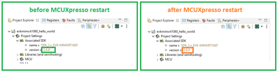

And now funny part: you are using SDK 2.9.3:
and want to import customer project using Import project(s) from file system... from Quickstart Panel. After importing, you can still see Associated SDK - version=2.8.6, so far so good. However, when you restart your MCUXpresso, Associated SDK changes to the one you currently use
5_associated_sdk_comparison.pngI found that the info about SDK is saved in .cproject file, provided with exported project. Therefore, I believe you can double-check SDK version the project has been created from initially:
