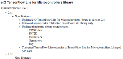

    • Why this example? Because in newer SDK (2.10.0) there is a change in TensorFlow Lite for Microcontrollers library to version 2.4.1 (so it will be easy to check if updating SDK in current project is taken into account)3_change_log.PNG
    • Change logs could be found in SDK_2_10_0_MIMXRT1170-EVK_doc.zip (you need to go online to your SDK dashboard and hit particular SDK, in my case SDK 2.10.0 as I am comparing SDK 2.9.0 vs 2.10.0 and then Download SDK Documentation)2_SDK_doc_change_logs.PNG

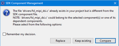

  6. Right click on project name -> SDK Management -> Refresh SDK Components and accept the incoming changes6_refresh_SDK_components.PNG
    • You will see popups as follows and seems it is up to you how you update these files (Replace, Keep existing or Compare)7_SDK_updating_questions.PNG
    • Remember: when you hit Compare and then Cancel, existing file will not be affected (when you are in Compare mode you need copy changes from newer file to existing file using buttons Copy All Non-Conflicting Changes from Right to Left and then hit Commit)
    • after few Replace clicks, you will see the question about version.h file and comparison looks like below8_SDK_updating_eiq_version.PNG
  7. After that, I have chosen to replace all the files and unfortunately project does not build any more, there are some problems with gprintf folder, and #include <chrono> in time.h,and few others, unfortunately no enough time to solve that
