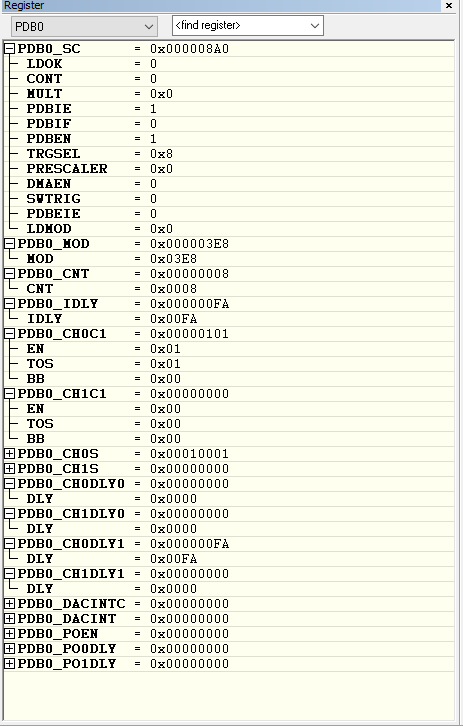

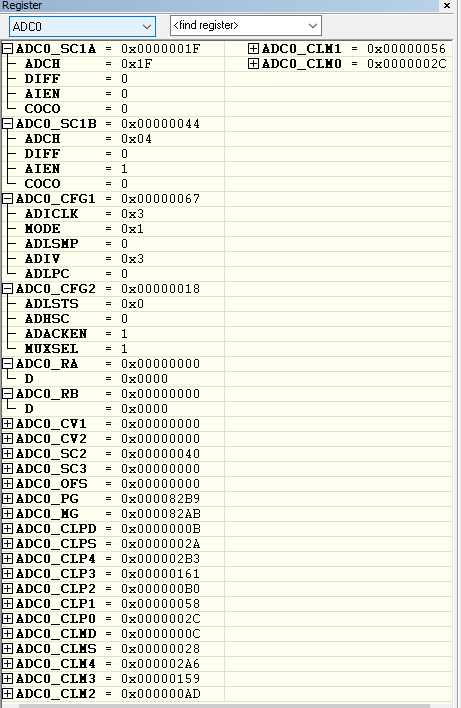

So i tried to configure ADC0_SE4b, but it's the same problem, no conversion start.
You can see attached the new program and pictures of registers state of PDB0 and ADC0 when i tested the new program located in this link : http://new_program_with_ADC0_SE4_b
Thank you.
BR.
Dhafer HANNAOUI
3,081 Views
xiangjun_rong
Hi, Dhafer,
I have three questions for the register setting of both PDB and ADC converter.
Firstly, for ADC, you  set the ADC0_SC1A as 0x1F, if the ADCH bits is 5b'11111, the ADC is disabled, pls change the ADCH bits to a valid channel.
Secondly, MUXSEL bits take effect on the both ADC0_SC1A and ADC0_SC1B channel.
Thirdly, pls check the PDB0_CH0S, the LSB of the register is set, which means that the ADC sampling has error, you should clear the bit so that the PDB can work after error happens. The triggering interval between two sampling must be greater than ADC conversion time.

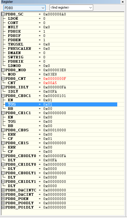

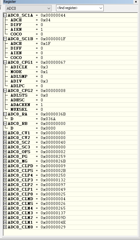

dhaferhannaoui
Thank you for your answer.
So in my program i configured ADC0 channel 4 as group B (ADC0_SE4b), so in the last pictures  ADC0_SC1B is set as 0x00000044 ( ADCH = 0x04), so the valid channel is selected.
And according to the ADC sampling error, i tested the same code but with configuring  ADC0 channel 4 as group A (instead of  group  B) (ADC0_SC1A as 0x00000044 ), so the LSB of PDB0_CH0S isn't set, so i think that i don't have problem in ADC sampling and conversion time.
you can see attached pictures of the register state (PDB0 and ADC0) after configuring ADC0 channel 4 as group A.
thank you.
3,081 Views
xiangjun_rong
In the register setting, I do not know why you set the ADC0_SC1B as 0x1F, when you set the ADCH bits as 0x1F, the ADC module will be disabled. If you do not want to get the second sample, you can set a valid channel and ignore the sample result in software, it is okay.
