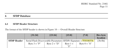

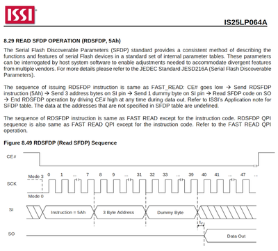

I would like to try to read SFDP parameters using the ROM API.
I read the documentation (both IS25LP064A datasheet and JESD216)
For this I modified the example evkmimxrt1020_fsl_romapi (which I have attached), to run in RAM and not to write flash.
Specifically, I added an entry in the LUT (I used the symbol NOR_CMD_LUT_SEQ_IDX_READ_SFDP that was already defined in fsl_romapi.h)
    /* Read SFDP */
    config->memConfig.lookupTable[4U * NOR_CMD_LUT_SEQ_IDX_READ_SFDP] =
        FSL_ROM_FLEXSPI_LUT_SEQ(CMD_SDR, FLEXSPI_1PAD, 0x5AU, RADDR_SDR, FLEXSPI_1PAD, 0x18U);
    config->memConfig.lookupTable[4U * NOR_CMD_LUT_SEQ_IDX_READ_SFDP + 1U] =
        FSL_ROM_FLEXSPI_LUT_SEQ(DUMMY_SDR, FLEXSPI_1PAD, 0x08U, READ_SDR, FLEXSPI_1PAD, 0x04U);
you can see that it's very similar to the read command.
