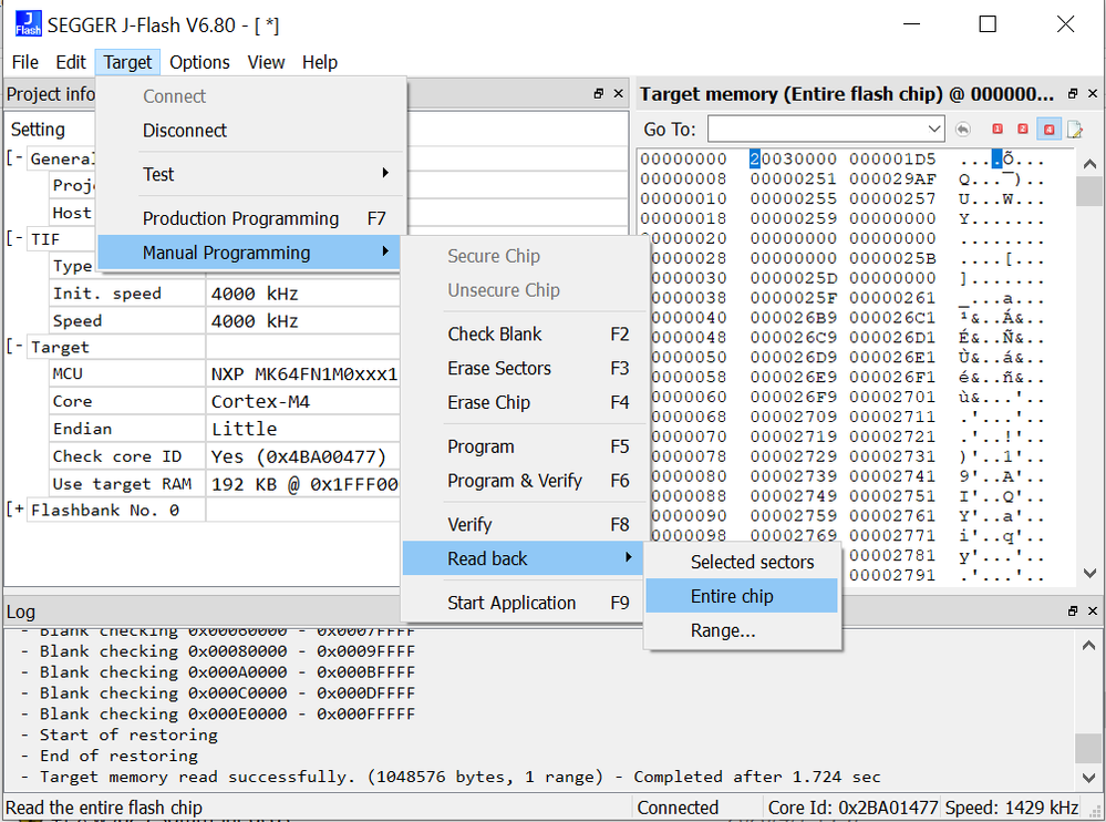

Hello ,
Is it possible to get firmware (xxx.axf) of the connected target (upload)?
I am having LPC LINK-2 in MCUXPRESSO IDE.
regards,
Hemanth
3,044 Views
jingpan
Hi Hemanth,
Do you want to read back firmware from target chip? You can only read back binary firmware. It's impossible to read  back .axf file. https://www.programmersought.com/article/3980249048/
MCUXpresso can't read data back. You can download jlink application to LPC LINK2 and use Segger software to read.
Jing

hemanthvasista
Hello Jing,
Thanks!! I was looking for a similar tool.
Do I need a J-Link license to use this?
I tried enumerate the LPC LINK-2 as J-Link, but it is unable to connect by USB.
I referred to below link:
https://www.segger.com/products/debug-probes/j-link/models/other-j-links/lpc-link-2/
Could you help me enumerate LINK-2 as J-Link?
Thanks!!
regards,
Hemanth
3,044 Views
jingpan
Please use this tool.
LPCScrypt v2.1.1 | NXP
Jing
3,044 Views
hemanthvasista
Hello Jing,
Thanks for your inputs. It worked for me now.
The problem, I forgot to put back the JP1 in LPC LINK-2.
Thanks for your inputs!!
regards,
Hemanth
