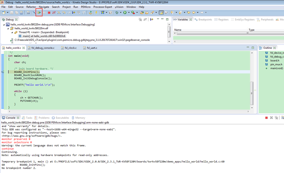

I followed all the steps to generate and donwload the file "SDK_2.3.1_TWR-KV58F220M" (MCUXpresso SDK and not KSDK).
Now I am following the steps from the document "Getting Started with MCUXpresso SDK". I try to run and debug the 'Hello word' example, but I have not been able to continue from this point (please see the attached picture)
As it is shown in the appendix B of this document, TWR-KV58F220M board has CMSIS-DAP as debug interface, however, the 'Hello word' example is not charged in 'GDB Open Debbuggin' (please see the attachment). What am I doing wrong.
And if I try with 'GDB PEMicro Interface Debugging', I get the following error message: Exception occurred during launch. Reason: error in services launch sequence.
Any help would be appreciated.
Thank you.

kerryzhou
Hi Customer,
  Normally, we use the JLINK or the opensda to download the code in KDS.
  I suggest you use the opensda or the JLINK to download the code in the KDS.
  Now, please modify your on board debugger to opensda or JLINK, then in the debug configurations, you can use:
1. opensda->GDB PEMicro Interface debugging
2. JLINK-> GDB SEGGER J-link debugging
About how to change the on board debugger to opensda or JLINK, please go to this link:
www.nxp.com/opensda
Choose board as TWR-KV58, then follow the step to change the firmware.
Please try it at first.
If you meet any problem when you use the JLINK or the opensda, please kindly let me know.

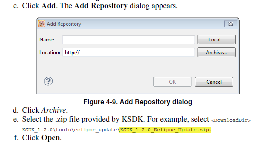

- I follow the 'KDSUG_Kinetis desing studio user guide' to install the sdk. I get the 'SDK_2.3.1_TWR-KV58F220M.zip' through MCUXpresso SDK Builder. However, in the user guide talks about a KSDK vx.x Eclipse update.zip.
Where should I get it?
What should I do with 'SDK_2.3.1_TWR-KV58F220M.zip' from the SDK builder?
As you can see I am pretty lost and quite desperate. Any help will be appreciated.

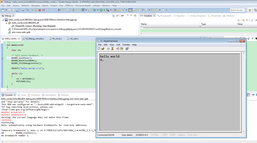

   4. Open the SDK helloworld code.
   KDS project folder:SDK_2.3.1_TWR-KV58F220M\boards\twrkv58f220m\demo_apps\hello_world\kds
  1)  Use the KDS open it, and build the project
   2) open the debug configurations, choose the GDB PEMicro Interface debugging.
The opensda debug is entered in.
 Now, open a COM Terminal to test the function.
Then click the resume button in KDS debug interface.
The above is the test result.
Please follow my steps and do it carefully.
If you still have question, please kindly let me know!
Kerry

patricio
Hello Kerry Zhou,
Thank you so much for your help. I appreciate your detailed steps. Everything went perfect.
Now, I can start working and fighting with the demoboard.

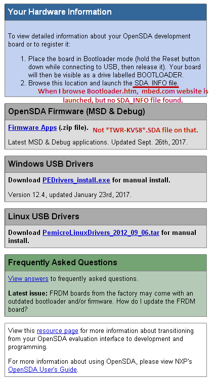

1) I go to: www.nxp.com/opensda.Check the Bootloader and Application version of my boad:
   1a) Bootloader: I get the file 'k20dx128_bootloader_0x8000.bin'. What should I do with it?
   1b) Default firmware application: No access to the website.
2) Download the OpenSDA application for my board:
I click on 'P&E Micro v108' and I access PEmicro website. I try to follow the steps in there. Please refer to the picture attached as "PEmicro.png"
   2a) Hardware information: I can not find SDA_INFO file.
   2b) OpenSDA Firmware: I get 'Pemicro_OpenSDA_Debug_MSD_Update_Apps_2017_09_26.zip' but there is not any 'MSD-DEBUG-TWR-KV58....' file. The nearest file is 'MSD-DEBUG-TWR-KV46F15_Pemicro_v119.SDA'
   2c) Windows driver: I downloaded and installed the driver. However, previously I installed already the mbed serial drivers. Any problem with that?

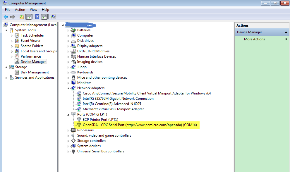

3) KDS, debug configuration:
   3a) The dispositive administrator recognizes the TWR-KV58 board in COM28.
   3b) However, in "PEmicro interface setting" it doesn´t shows nothing in PORT.
   3c) It shows the following message: "Plugin has not been registered. Some functionality may not be available". What is it about.
