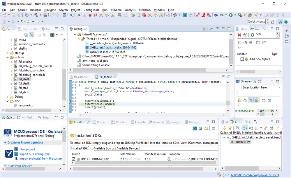

Also getting same problem running frdmkl27z_shell example project straight out the box from the frdm_kl27z demo examples.
The example is being run in the default DEBUG configuration.
The other semihosting example called frdmkl27z_hello_world works perfectly.
The Assert fails because SerialHandle is null.

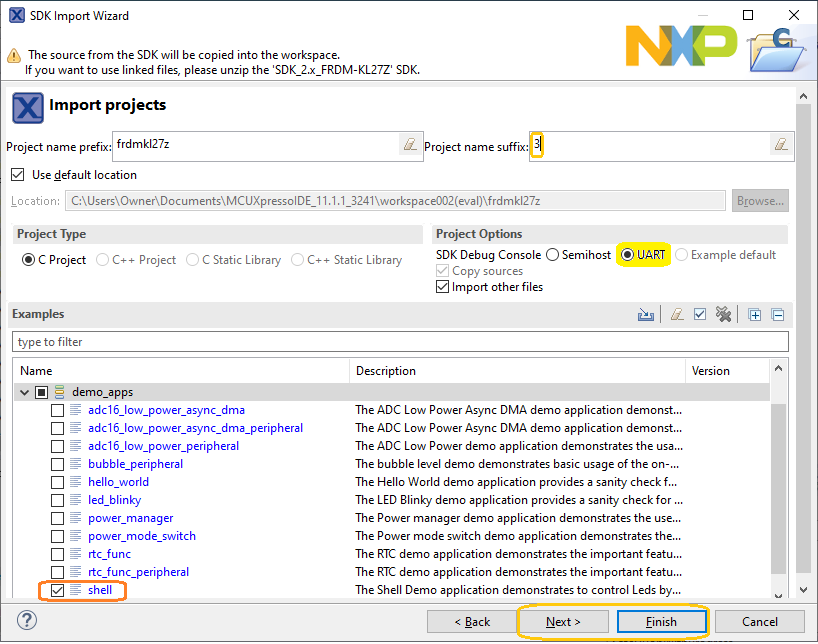

admin6
Hi Alan,
  The solution is to ensure that;
       SDK Import Wizard  ->   SDK Debug Console   = UART            (not Semihost! The default)
 as shown below.
(Also you need to give the second attempt at importing this project a suffix so that the [Next] and [Finish] buttons are ungreyed - allowing you to proceed.)
The imported project settings do NOT control the "SDK Debug Console" setting. You have to set it manually.

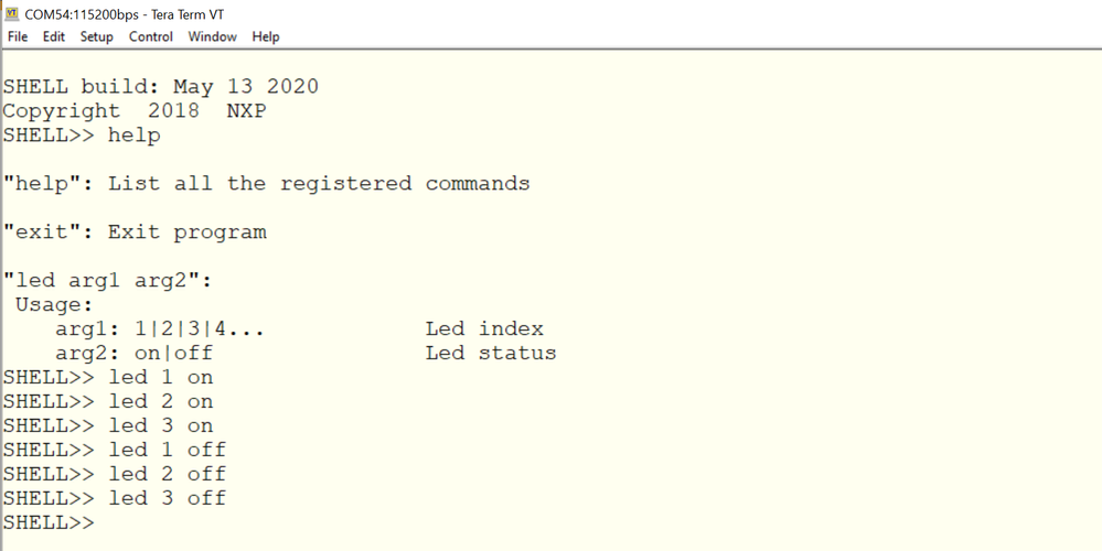

FelipeGarcia
Hi Alan,
I checked the example on my side using my LPCXpresso54608 board and it worked as expected. Please check the below image.
I used MCUXpresso 11.1.1 and SDK 2.7.0 to test it.
