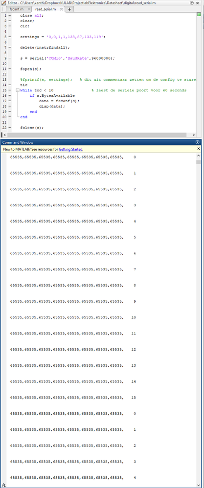

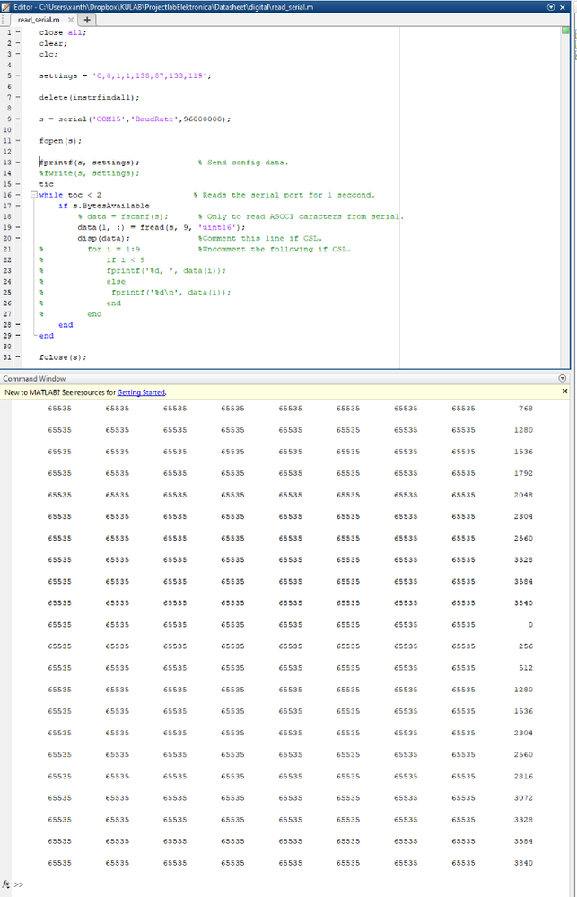

In a project with an 8 channel 12-bit simultaneous sampling ADC, the sampling rate is 100kHz.
So every 10µs the MCU needs to forward the data + a time difference, via USB to a host PC running Matlab.
In its raw form and comma separated, 26 bytes. In a timeframe of 5µs -> 5,2MB/s.
In ASCII formatted and comma separated, 56 bytes. In a time frame of 5µs -> 11,2MB/s.
The time frame is only an assumption, the other 5µs is to accommodate the other functions that need to be done.

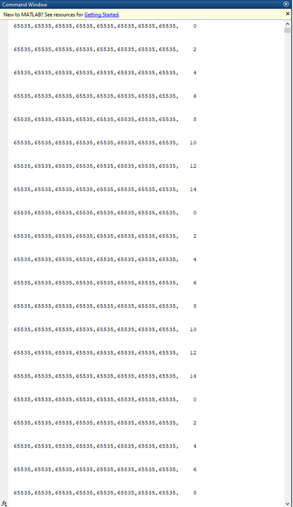

The CDC class from the example can follow until an interval of 200µs. But after 16 transfers it stalls for 240 counts!
How come? Please advice.
Following the print screen at the receiving end in Matlab, with an interval of 200µs, 100µs and 10µs.
An example with only the bare necessities added to simulate the USB communication.
The number at the end is a count 0->255!

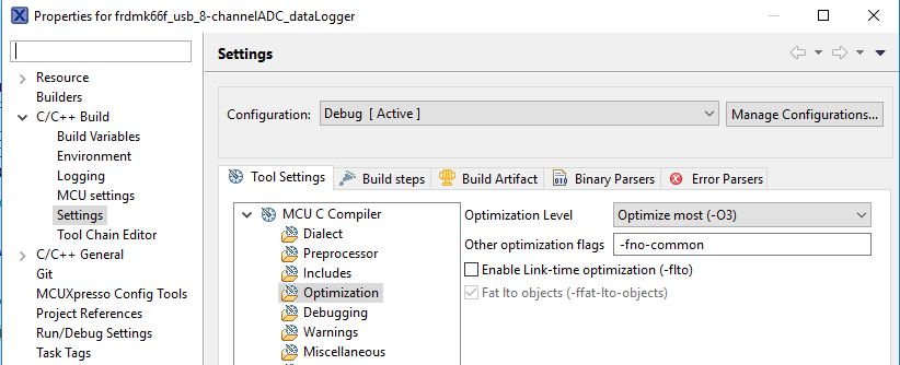

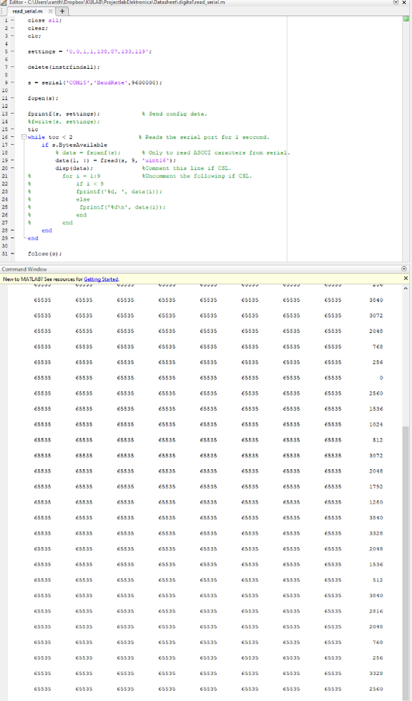

Hi mike
I changed the optimization level to the highest level, but that makes no difference.
The last number is the value of a counter 0 -> 65535!
I'm still hoping to see this solved.
Pascal

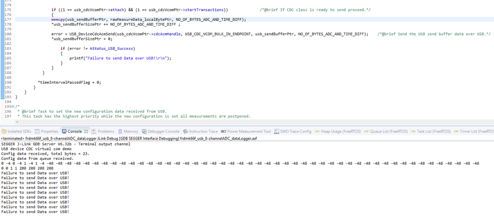

xanthurum

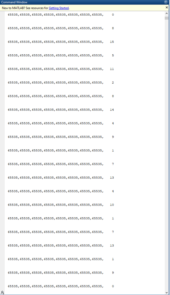

Dear Mike
I made the 'intervalCount' variable global as you suggested, that makes no difference.
I'm pretty sure it is the driver that can not follow the pace.
This is the send function and the errors because the Vcom driver can't cope.

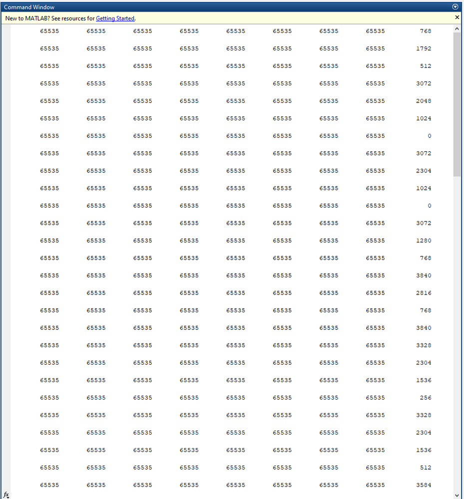

The result on Matlab.
The interval is not even 10µs in that example.
This is the result with an interval of 10µs:
Pascal

Dear Mike
Yes indeed, every 10µs the ADC data + a timestamp difference has to be send to the USB host.
Besides running the code to get the measurement data from the ADC.
In the Matlab program the 96000000 is the serial baud rate.

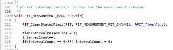

In <virtual_com.c> file, the APPTask() function, there call below function to calculate the time difference.
uint16_t timeDifference = TimersAndCo_GetTimeDifference(); //At the moment only a count 0 -> 255
We don't think below function is robust, there need consider PIT timer overrun.
We recommend set a global variable as counter, which add 1 every set time interval passed (for example 200us).
 * @brief Function to get the time difference.
 * @return uint16_t µs_difference    -> The time difference in µs.
uint16_t TimersAndCo_GetTimeDifference(void)
    uint64_t currentTimerValue    = COUNT_TO_USEC(PIT_GetCurrentTimerCount(PIT, PIT_TIME_DIFFERENCE_CHANNEL), PIT_SOURCE_CLOCK);
    uint64_t timeDifference     = lastTimerValue - currentTimerValue;
    lastTimerValue                = currentTimerValue;
    //return (uint16_t)timeDifference;
    return intervalCount;
Then use that counter variable will check if there with the data lost issue.

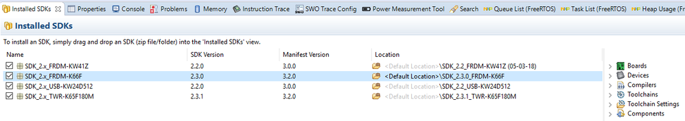

Dear Mike
These are the SDK's I am using, the version of the FRDM-K66 SDK is 2.3.0
Pascal

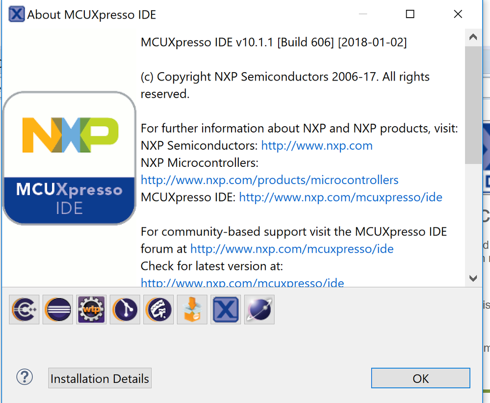

The version of the IDE I am using.
Pascal
