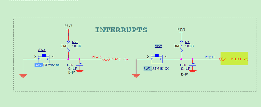

Kerry, actually your answer is incorrect. SW3 is on Port A (PTA10), but SW2 is on Port D (PTD11). My question concerns the sharing of SW2 and SDHC, which I believe are shared on PORT D (not A).
Can you please confirm my understanding and also re-address the shared interrupt for SHDC and SW2.

  Sorry, really my mistake, SW2 is PTD11.
  So you can use PORTD IRQ.
  But PORTD and SDHC still not the same IRQ, they will cause the different interrupt.
   If you want to use all the port and SDHC interrupt, you just need to enable the related interrupt IRQ, you don't need to use just one IRQ.

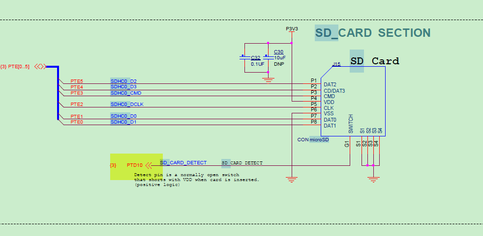

There is one interrupt handler for port D - 'PORTD_IRQHandler', but in my case it needs to handle both the SDHC card inserted interrupt source and the SW2 interrupt source.
From your SDMMC example code, in fsl_sdmmc_host.c you define the Port D interrupt handler:
void SDMMCHOST_CARD_DETECT_GPIO_INTERRUPT_HANDLER(void)
This function handles the SDMMC card inserted interrupt source.
In the general case, how would you recommend I structure my code if a) I wanted to integrate the supplied SDMMC code and b) I had other Port D interrupt handling requirements that were specific to my application only. Obviously I want to minimize the changes to fsl_sdmmc_host.c.

You means the PTD10(sd card detect pin) also use the PTD interrupt handler, and you also want to use the SW2 PTD11 interrupt right?
 But PTD10 and PTD11 share the same PORTD_IRQHandler, so you are confusing, right?
 If yes, you totally don't need to worry about it, please check these register:
So, in your PORTD_IRQHandler, you can check PORTD_PCR11[ISR] and the PORTD_PCR10[ISR].
If PORTD_PCR11[ISR] =1, it is the sd card interrupt.
If PORTD_PCR10[ISR]=1, it is your SW2 interrupt.
Wish it helps you!

Thank you again Kerry for the timely and detailed response. I had mistakenly thought that the SDHC Card Detected hardware signal was on port A, and therefore the interrupt had to be shared with other Port A peripherals. Thank you for your clarification.

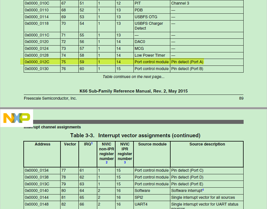

    PortA and the SDHC interrupt are the different IRQ:
So you totally can use two Interrupt handler, why you need to use one port A interrupt handler to process both port and the SDHC interrupt handler?

  SW2 is the PTA10 pin,
 If you are using the normal interrupt, when it is pressed, the code will enter the PORTA interrupt handler.
  After the interrupt exit, the code will run your SDHC code again. The SDHC still can be used.
  You can refer to the SDK code for FRDM-K66, then add your port interrupt.
