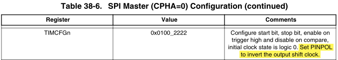

I'm evaluating FLEXIO as SPI using SDK v3.2.1 on a FRDM-KL27Z. Basically I'd need to solve 2 things:
  • Set the CLK Polarity Active Low, not High as provided in the frdmkl27z_driver_examples_flexio_flexio_spi_int_spi_transfer_master
  • Disable CS assertion by the driver. I need to set/clear the CS manually. Similar way than the output mode configuration (kSPI_SlaveSelectAsGpio) in the SPI driver.
How can I do to accomplish these points?

gerardo_rodriguez
Hello Gaston,
The FlexIO SPI driver doesn't support CPOL=1 (idle high), but as mentioned in the KL27P64M48SF2RM, you can manually change the pin polarity of the timer used for SCK generation to support this:
In FLEXIO_SPI_MasterInit():
    /*3. Configure the timer 0 for SCK. */
    timerConfig.triggerSelect = FLEXIO_TIMER_TRIGGER_SEL_SHIFTnSTAT(base->shifterIndex[0]);
    timerConfig.triggerPolarity = kFLEXIO_TimerTriggerPolarityActiveLow;
    timerConfig.triggerSource = kFLEXIO_TimerTriggerSourceInternal;
    timerConfig.pinConfig = kFLEXIO_PinConfigOutput;
    timerConfig.pinSelect = base->SCKPinIndex;
//    timerConfig.pinPolarity = kFLEXIO_PinActiveHigh;
    timerConfig.pinPolarity = kFLEXIO_PinActiveLow;
About the CS pin, you can manually change the pin muxing to GPIO instead of the FlexIO so you can manually control it.
