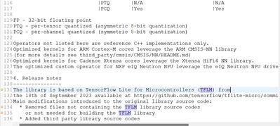

Alex_Wang
Hi, @nnxxpp
Currently, SDK2.15 is Updated TensorFlow Lite for Microcontrollers to version 23-
09-18. You can find it in C:\Users\nxgxxxxxx\mcuxpresso\02\SDKPackages\SDK_2_15_000_EVK-MIMXRT1060\middleware\eiq\tensorflow-lite\readme txt file.
Best regards, Alex
