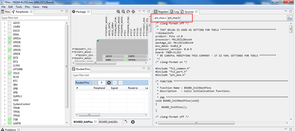

I've created a project using the FRDM-K66F SDK and see an empty pinmux file, yet it works just fine with the board.  Using the project generator tool and importing the result to the IDE gives me a project with actual values in the pinmux files, but it does not offer the option of building or debugging.  What am I missing here?

The functions BOARD_InitPins(void) in the file of pin_mux.c  is the pins which customer used,
if there is no pins to be used,  it will be empty, and it won't impact the project to build and runs.

Yes, the pin_mux.c file is empty when you create a new project , for you haven't configure any pins now.
I recommend you use the "MCUXpresso Config Tools" MCUXpresso Config Tools|NXP configure pins,
then it will generate pins_mux.h and pins_mux.h files , use the them replace the default two files on your project.
