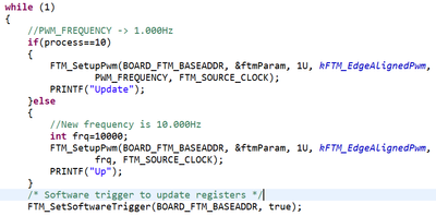

I use an FTM function to generate PWM output. I based my code on the SDK example "driver_examples => simple_PWM".
Actually to change PWM frequency I use "FTM_Deinit", then "FTM_CalculateCounterClkDiv" to modify frequency and "FTM_Init". But it's a really slow solution and it's not working properly if I modify my frequency many time too fast.
Is there a way to change dynamically the frequency (like duty cycle on the example) ? Have you got any example ?

Hello @Marc852,
  • Just to double check, could you please check the configuration of the port for the FTM0_CH3 in pin_mux.c file of your project? Here is the configuration from the driver example "ftm_simple_pwm" using CH6:
  • In order to change frequencies, you may need the following line FTM_SetSoftwareTrigger(BOARD_FTM_BASEADDR, true); without it as you point out the frequency will not change. Could you please try to add the line every time you want to change the frequency after FTM_SetupPwm? Here is a sample of how the testing was made.

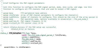

Hello @Marc852,
In the example you have function: FTM_SetupPwm(). This function has a parameter named pwmFreq_Hz, that is for PWM signal frequency in Hz.
[Function FTM_SetupPwm in main]
[Declaration of function in fsl_ftm.c]
You could experiment with that function and modify the frequency of the PWM, without the use of FTM_DeInit() and FTM_CalculateCounterClkDiv.
Regards, Raul.

Marc852
Hello Raul,
Thanks for your help.
I had already seen this function but it did not work dynamically.
I tried again with FRDM-K22 demo board. I started PWM with 1 KHz and I modified it to 10 KHz with "FTM_SetupPwm()". Nothing happened on output, I kept a 1KHz frequency.
Did I made a mistake ?
I attach my test source files.
Cordially,
Marc

RaRo
Hello @Marc852,
Could you please check if you are entering this condition?
[Driver fsl_ftm.c -> function FTM_SetupPWM()]
Due the range of frequency you are wanting to work, the function will not work it out. This is because the number of ticks the counter needs will overflow the mod register every time. FTM_SetupPWM() then, will only work with a lower range.
As you can read in the comment, the best solution for your range would be: Changing clock source to get the desired frequency. As you were doing in the first place.
Regards, Raul

Marc852
Hello @RaRo,
This works perfectly by adding the function FTM_SetSoftwareTrigger(BOARD_FTM_BASEADDR, true) !
Looks like I missed it..
