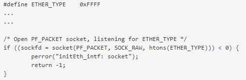

Hello Community,
I wanted to receive Ethernet frame using a packet socket supported by PF_PACKET family. Is this support available for FreeRTOS stack integrated in MCUXpresso IDE v11?
Or could some one help me in receiving raw Ethernet frames of specific protocol (say specific Ethertype) which is not a standard one?

Hi Zeke:
Socket API in lwip is bulit on top of the sequential API.  I don't see support for PF_PACKET in current version of lwip.
Please refer to below link for more details.
lwIP: Socket API
