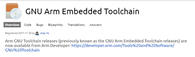

vix
I understand NXP position, but I want to highlight a couple of things:
  • At Arm GNU Toolchain Downloads – Arm Developer you can find the up-to-date release of the toolchain (I'm sure you already know it)
  • The reason why I tried the new release is that the old ones has issues (with GDB) with the recent Ubuntu 22.04
I understand that you can "force" the developer to stay with old well-tested release of toolchain, but soon or later an update is necessary (for whatever reason).
Is there any chance that a newer release is validated with SDK in the next few months?
