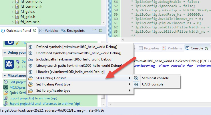

BTW, you configure the SDK debug console by following the below figure.

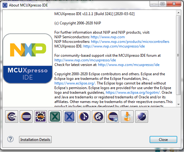

Here is the version of MCUXpresso

Ok I have found the issue.
It was the fact that I had another SDK for the same CPU installed but an earlier version, V2.4.0.
If I untick the checkbox in the Installed SDK's for the older SDK then import the hello_world example from the latest SDK it all works as expected.
Looks like the import SDK example wizard pulls some of the files from the wrong SDK if you have multiple ones installed (At least on my machine).
